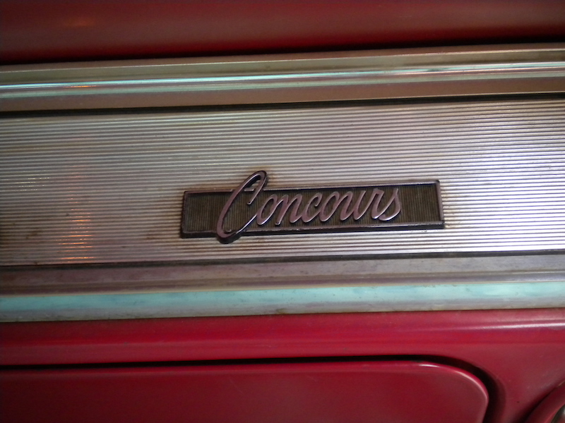

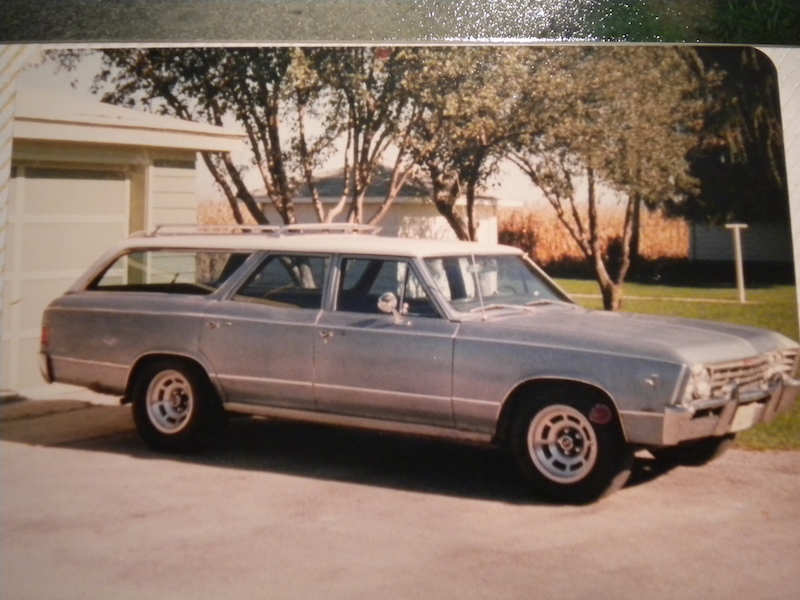

Not a Musclecar by any means, but some here have shown interest, and being a '67 Chevelle I'm all in!
I bought this wagon from the original owner's son in 1990 and drove it home from Palmdale CA, added a quart of oil and had a blown tire in Montrose CO.
Having spent its life in a rural high desert environment it was loaded with sand everywhere and had a tough as nails film of dirty scum. That film acted to protect some nice finishes once removed. What it doesn't have is any rust, anywhere, beyond minor surface rust. As you can see the paint is chalked out and the woodgrain is toast.
A top trim level Concours wagon, the first year woodgrain was applied to a Chevelle, options are L30 327/275 with Powerglide and CA smog. PS, PB, A/C, power tailgate window, AM/FM radio and front bumper guards. What it doesn't have, and seems odd for top trim level, is roof rack and no option dog dish caps.
I will post more on bringing this wagon back to life and making it the best it can be. - Bill W

A total of 6,299 Concours wagons were built, including six cylinder, 283, L30 327, and extremely rare L79 327.
I had not done anything with it since 1990, always bypassed by other Chevelle projects, but it's time! The plan is, thorough cleaning and degreasing, making it roadworthy and dealing with some eyesores while keeping any painting to a bare minimum.
