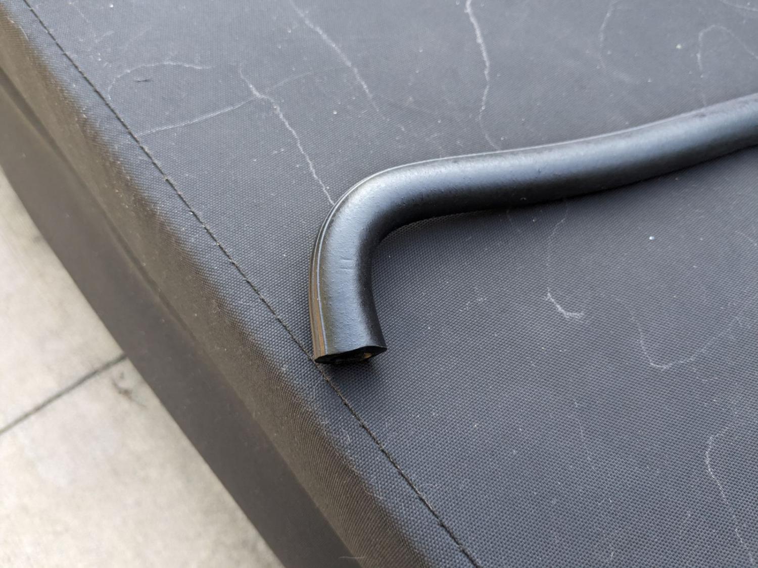

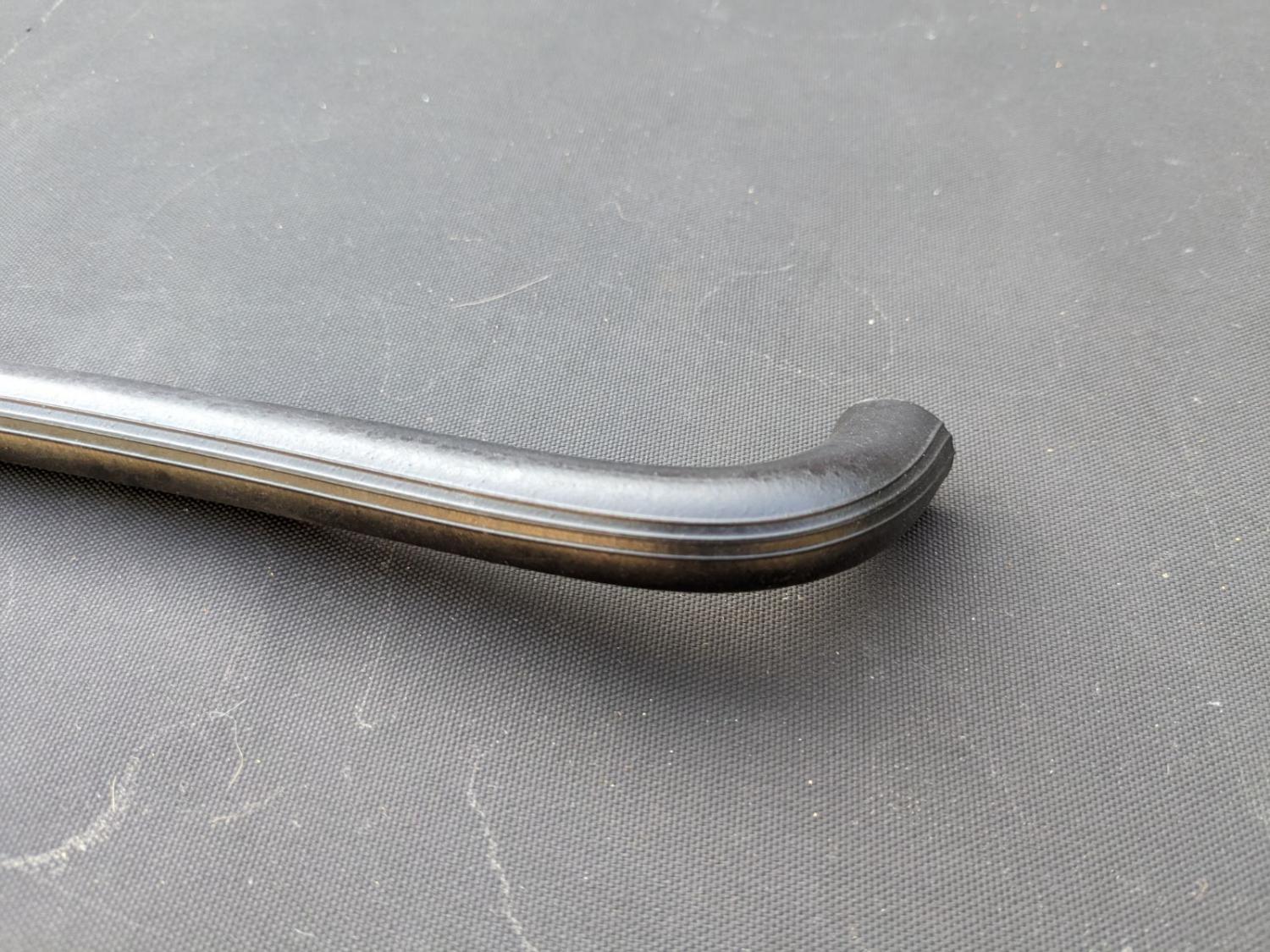

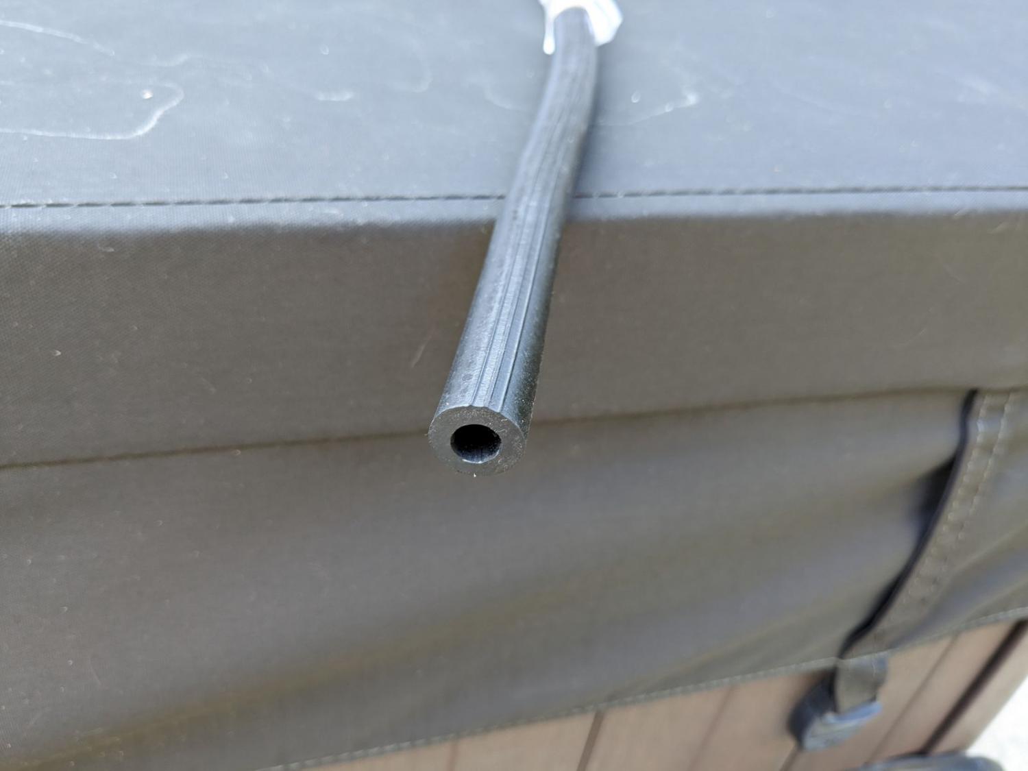

Does anyone know of a vendor for the correct PCV valve hose for a 69 Z... the ones that are commonly marketed as reproductions are not correct.
The reproduction hose looks like a piece of 3/8" cord re-enforced rubber fuel line... the orginals had a few ribs and what appears to be a little bit larger OD.
Here is a pic of the Camaro Specialties Barn Find car...
I have seen other unrestored cars with the ribbed hose as well...

Wow! Never knew that hose was a ribbey, did this change for '70? If not, it's just another item to change on deuce

I just recently noticed the difference... I was studying engine pics for correct finishes brackets etc and saw the hose...
