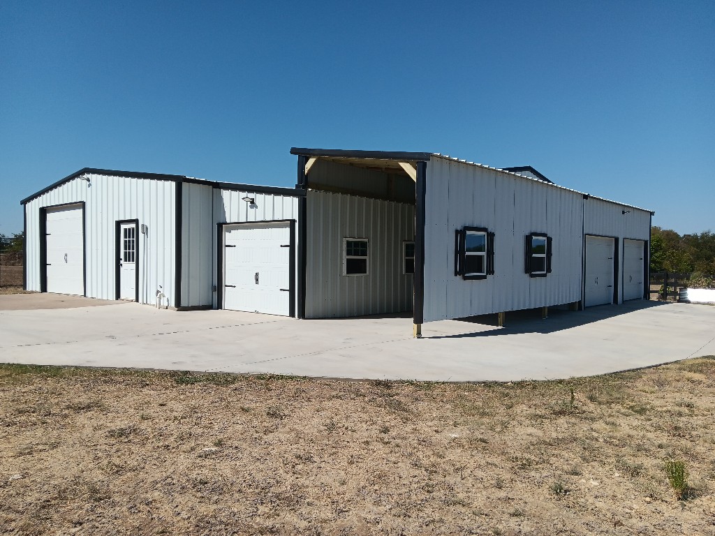

So first thing was protection from the weather and such. That means an extension on the extension to the shop I had already built a year ago. What do I know about…wait, we’ve already been down that road. Anywho, several 2x6s, 2x10s, concrete wedge anchors, R-Panels and three days later and we have an RV port. I left the bottom open for airflow through the port to prevent lifting and such. This all engineered correctly since three days after I built this we had a gust front come through with 65mph winds and fortunately, no pieces left the scene. Now it’s onto the van!

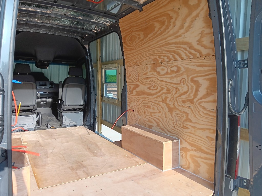

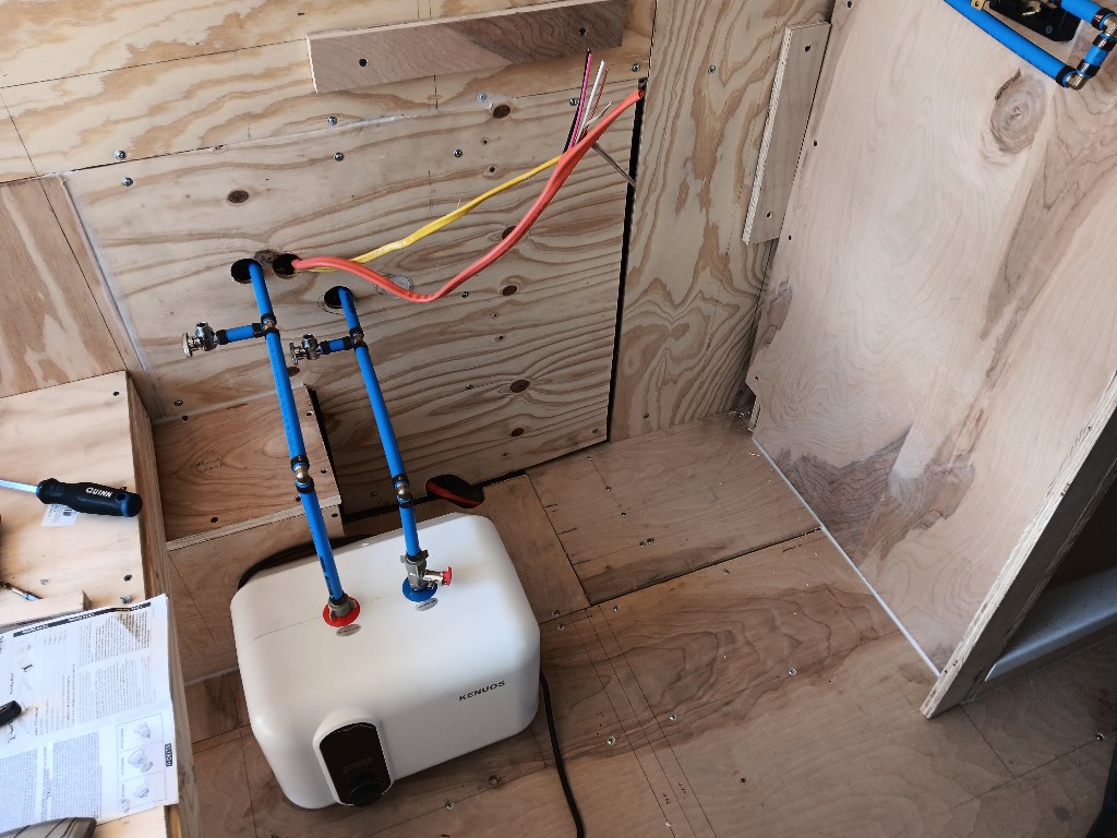

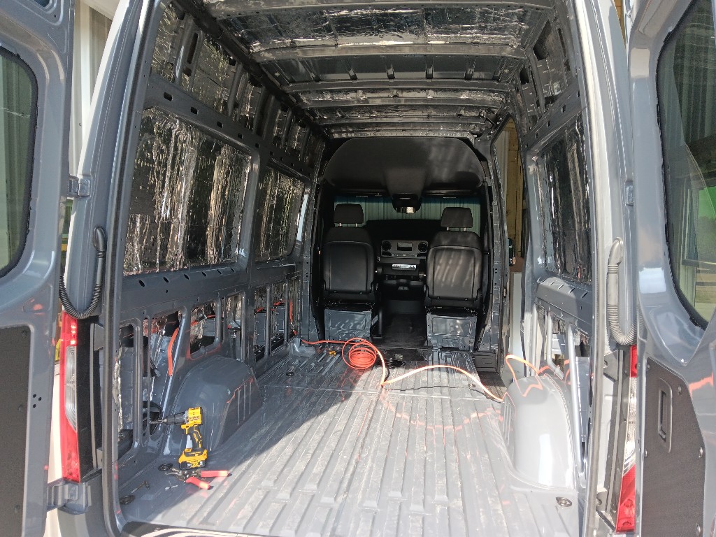

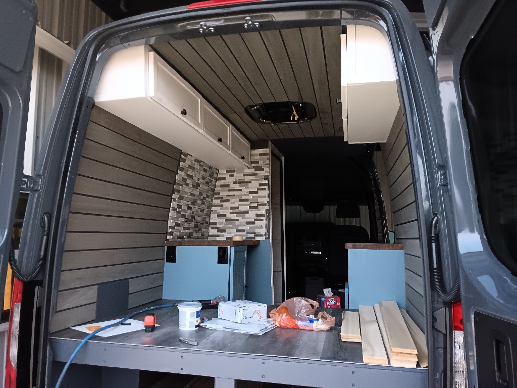

I ran the electrics and plumbing and pressure treated the lines before the walls went up. PEX plumbing will make a plumber out of anyone! I decided to do the electrics like I did the last one which is just run hard lines to plugs on the exterior of the van so there’s no fuses to deal with. Basically, just run extension cords to the shore power hook up. AC is on it’s own circuit and the other things are separate. I checked out the amp draw and decided to leave the AC on it’s own circuit. I will say that cutting a 16” square hole in the roof of a brand new van is a little unsettling. There’s a shower and a sink but no potty which means a gray water tank but thankfully, not black water tank. Don’t want to deal with that sh…well, you get the picture. The 40gal gray water tank slips right under the driver’s side in an empty space like it was designed for it. Actually, it was! And RV supply house provided that along with several other RV specific thingies we needed. The shower features a retractable door which squeegees the water off when you close it. It’s lined with interlocking water proof panels which make shower installation a breeze. A two gallon hot water heater under the sink provides just enough hot water to do a quick shower and wash your hands at the sink.

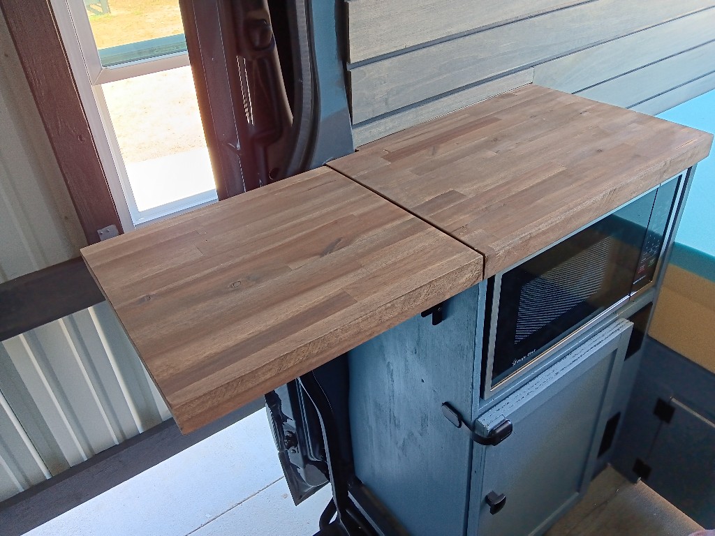

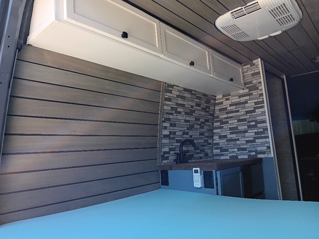

Other features are a swivel seat for the passenger and a removable table that swings around and is adjustable high/low. Fridge/Freezer combo along with a microwave. Three outlets strateegerly positioned throughout and two overhead ceiling lights on a dimmer switch round out the conversion. I hooked this up to my shop’s 50A with a splitter/converter and powered everything up with no issues.

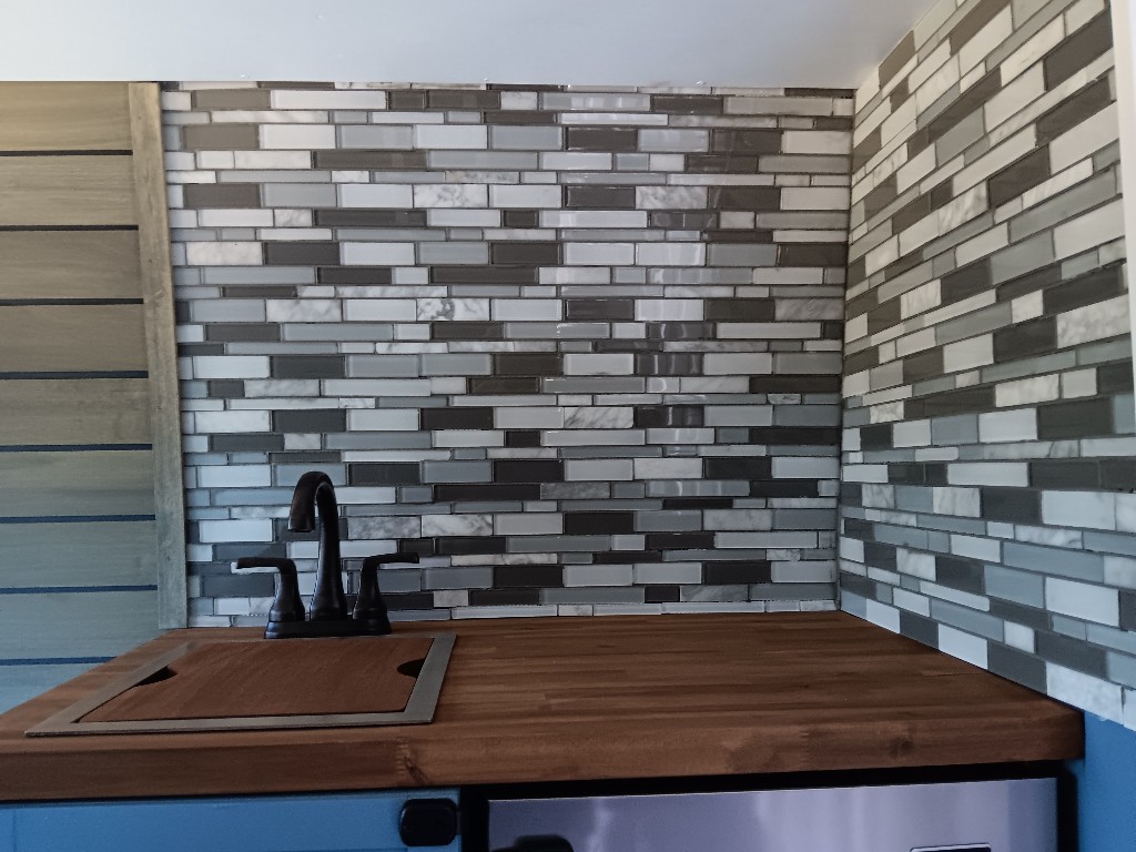

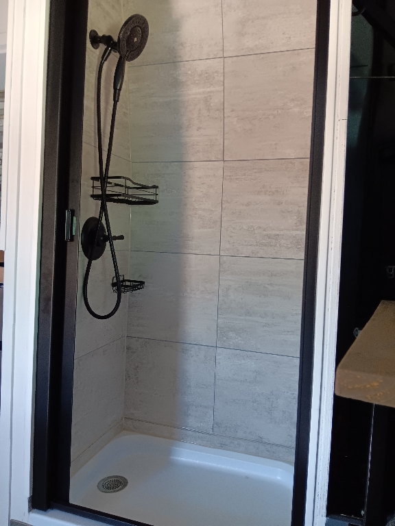

So let’s see: plumber, carpenter, electrician, tilesmith (tilesmith?), laminate floor installer. Add those to the resume!! Pricing these things out almost makes me want to list the van for sale. What they go for when done like this is astounding. But nah, I don’t want to do this again and I have a car to finish and two more to do behind that one!

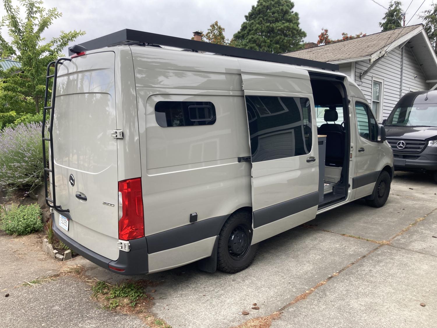

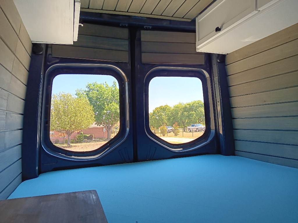

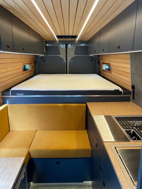

Here's the final product! Ready for new adventures while I stay in the local Hilton! Kelly also ordered magnetic black out shades which fit in all the windows and snug up against the window frames. Really slick and good for privacy. No funky straps and such to deal with. The accessories they offer for the camper conversions are pretty interesting.

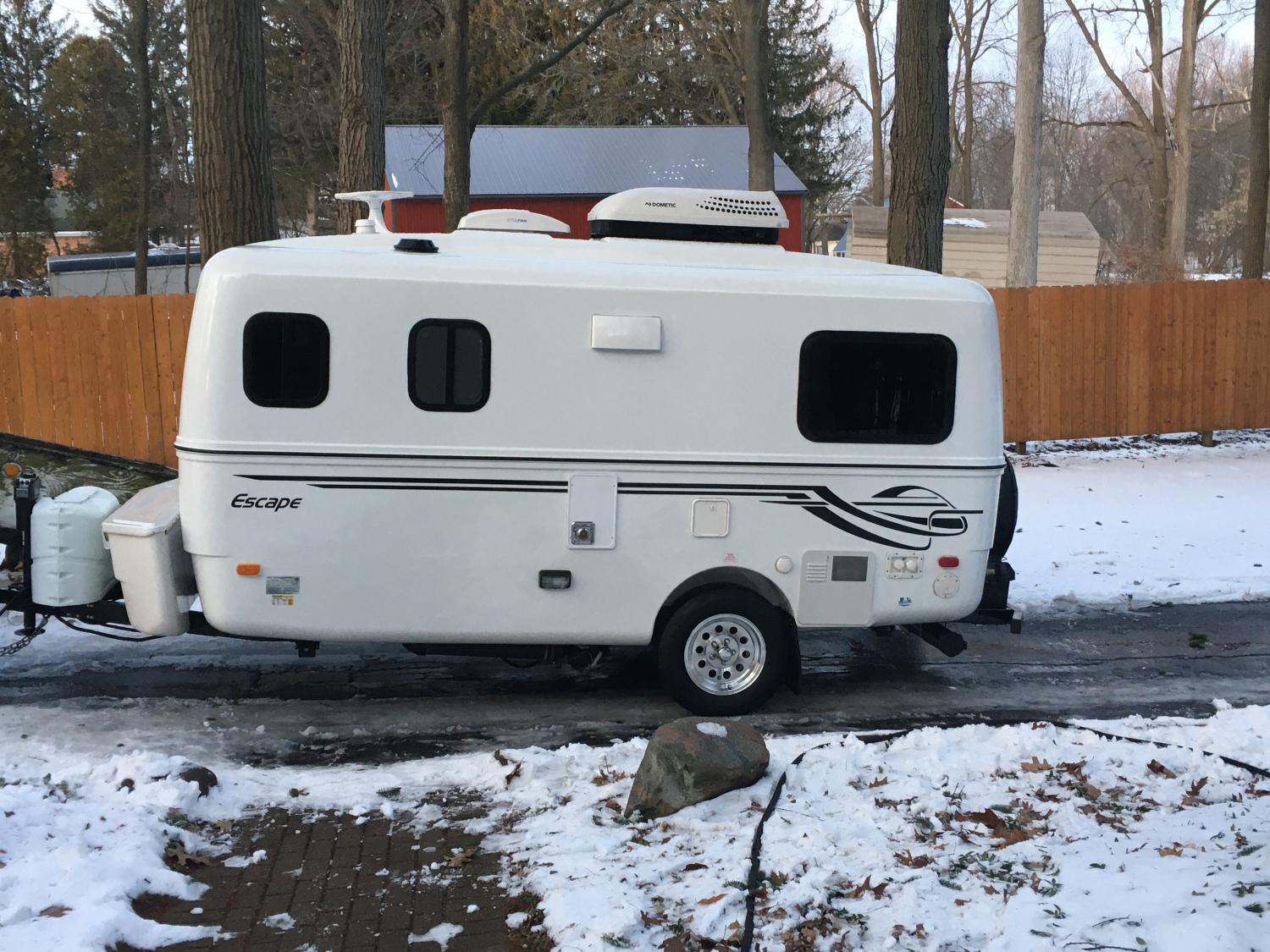

a) In a similar vein, I ascribe to the "Happy Camper, Happy Wife" philosophy. We purchased a small camper trailer back at Christmas and are enjoying the heck out of it.
b) Having said that, during one of our trips we met a couple that were doing what you are doing here; the guy was a retired college professor and converted his MB van into a camper. Looks like a very similar floor plan. He dabbles in wood working and made his own bed (and now lies in it, I suppose).
