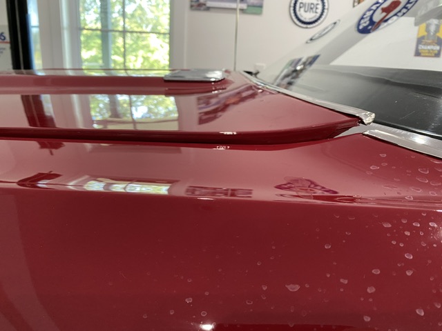

Hi Guys, the hood on my car does not fit right on the driver side rear. It sits up too high, the passenger side is fine. I have tried to pivot the driver side hinge, shimmed it which helped but seems as if I need to start all over and carefully install the hood. The car has OEM fenders on it and OEM header panel. Any process help is appreciated.

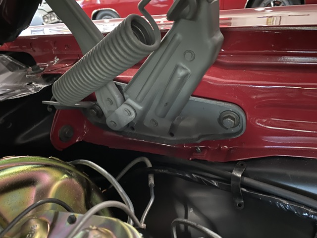

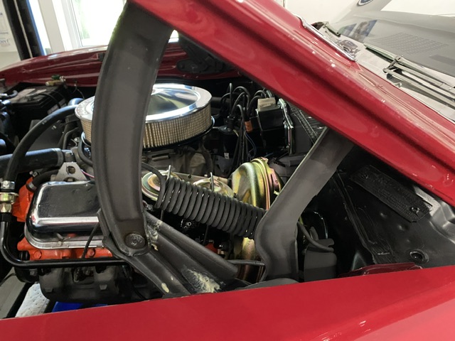

Pictures of hinges.

Strange looking rivets, not original. Aftermarket ? Left forward arm is binding badly too.

Regarding the hood hinges, they were on the car and looked aged so thought they were original.
I have tried to pivot hinge no luck.
