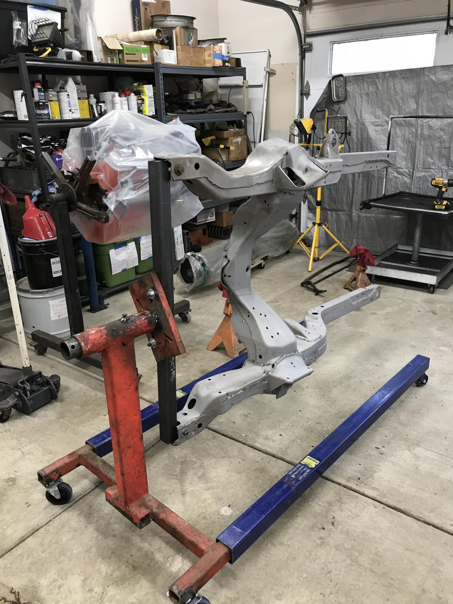

Old 02-17-2024, 04:07 PM
Join Date: Sep 2016
Location: Dayton Ohio
Posts: 926
Thanks: 317
Doesn't hurt to have a subframe rotisserie either

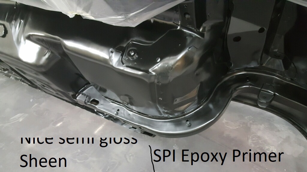

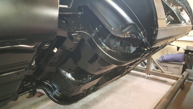

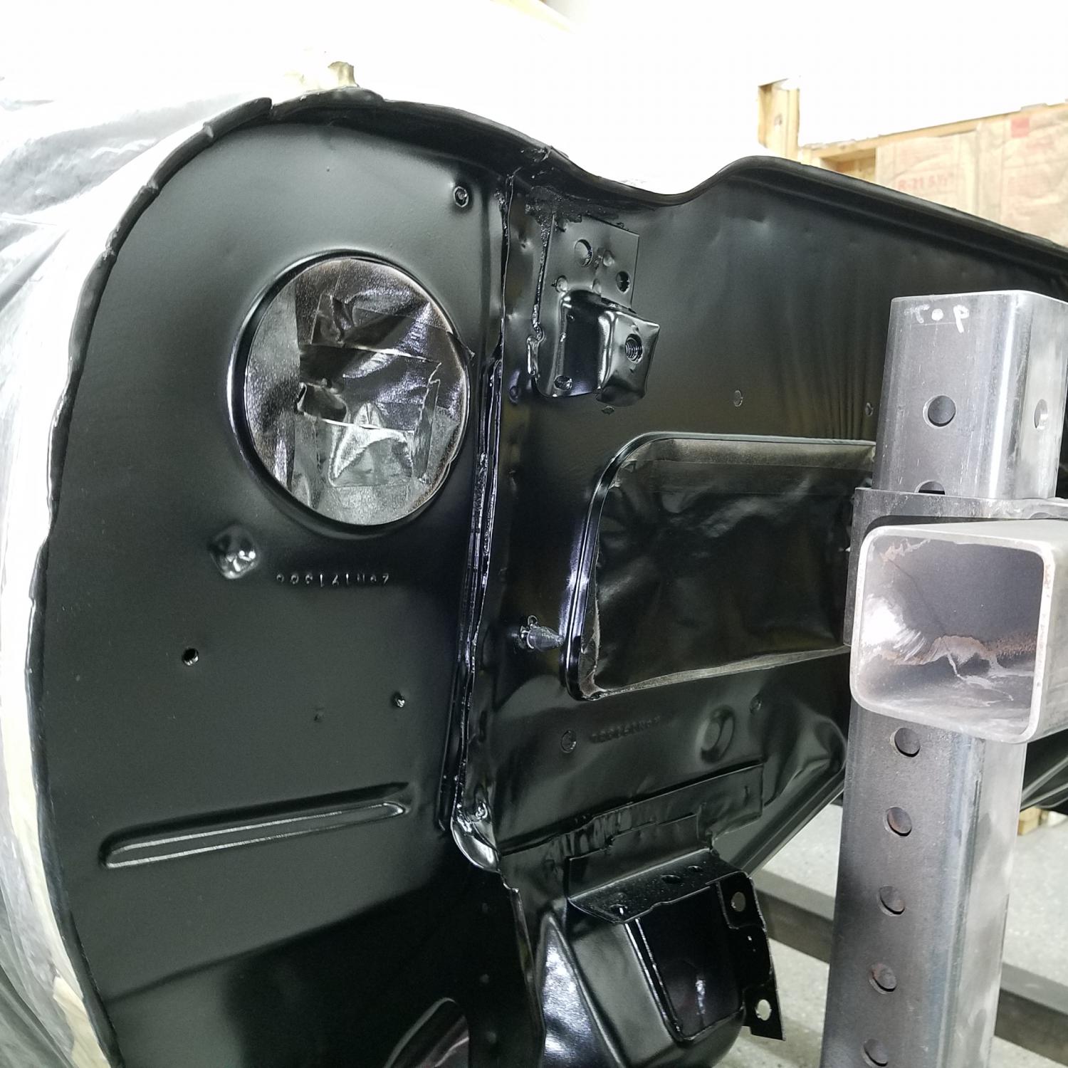

Here are pics of SPI Black Epoxy on a Camaro Underfloor
and pics of PPG Delfleet Essential mixed to the Semi Gloss
Formula on the Firewall (with SPI first on the sandblasted metal)
DAVE, My painter added ??? %% of Reducer to the SPI and its Flowed
Out Very Smooth............I'm not sure how he applied the Delfleet.....
Can you write something about how flat, smooth you got the PPG Delfleet
with NO Orange Peel
People should use SPI Epoxy bought directly from SPI (you must call them)
Shipped to your door for Significantly less than the major name brands....
70% of their business is restoration....Mfg in Georgia...........
Mixed 1:1 with activator I buy in qts as the activator shelf life is short after
the can is open......(versus opening a gallon)
Chuck Sharin
