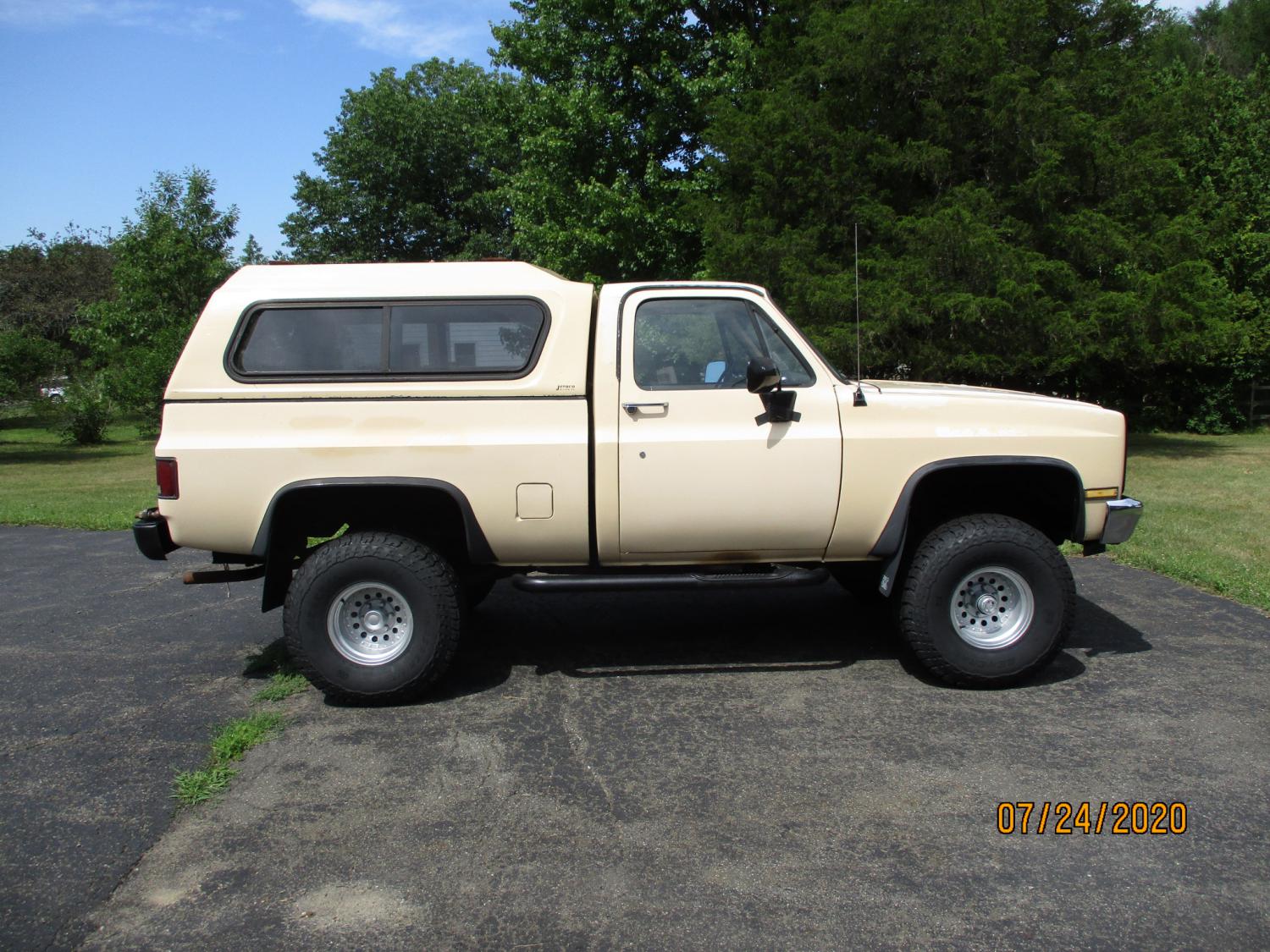

Looking for suggestions for clamps and gaskets for re-mounting the Jeraco cap on our 85 GMC Sierra short bed.
Cap is on kind off center...we get water in the back during a rainstorm.
Truck has sprayed bedliner on the rails...I'm thinking we need a double layer of the stick on tape.
Clamps are old and mismatched....time for a refresh. I may clean the bed inside and respray the bed-liner while it is apart.
Any help is appreciated.
-wilma

There are 4 of these on my 6.5 topper and it doesn't move. Yes, double the seal tape on the bed liner rail. My rails are bed liner too. I've seen some of the front panels top rail be lower than the sides and need an extra layer of seal too, if the water is getting in the front. The only area that leaks on my A.R.E is the door gasket. Their design/seal sucks.
