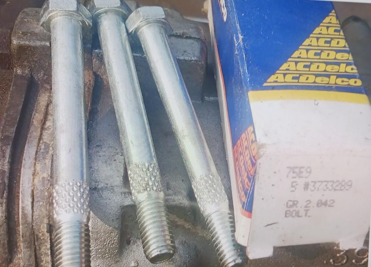

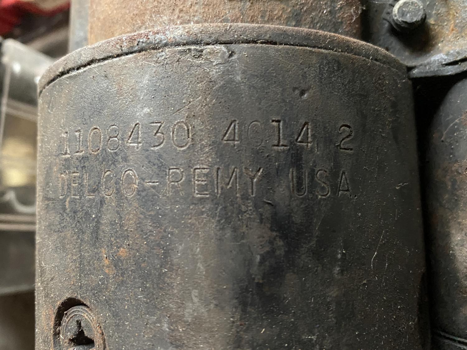

Trying to piece this together. I’m trying to figure out what starter I need for a COPO car with an automatic trans. I’ve seen 1108430 listed for automatics and 1108418 for manuals. However, in trying to hunt for a 1108430, I can’t find anything dated before 1970?
Anyone help shed some light on this for me?

Thanks guys for the response, the car is a 427 COPO. I just read across it and was curious as if I had my thinking messed up. When the car was purchased it didn’t have the original TH400 behind it. I just remembered it not being the correct 418 starter. I went out just note to check at what came off of it and of course it’s a 430. However it is dated for 1974. I’ll probably just go ahead and snag a 418 and call it done.

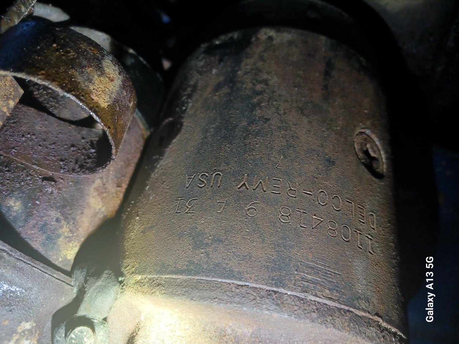

Old 06-13-2024, 05:54 AM
Posts: 2,668
Thanks: 111
Thanked 235 Times in 87 Posts
My 9 K 22 ...1108418 starter has Aluminum Nose Casting...
What application was this ????
Could this Sept Starter still have been used for late 69 Camaros ???
Thanks

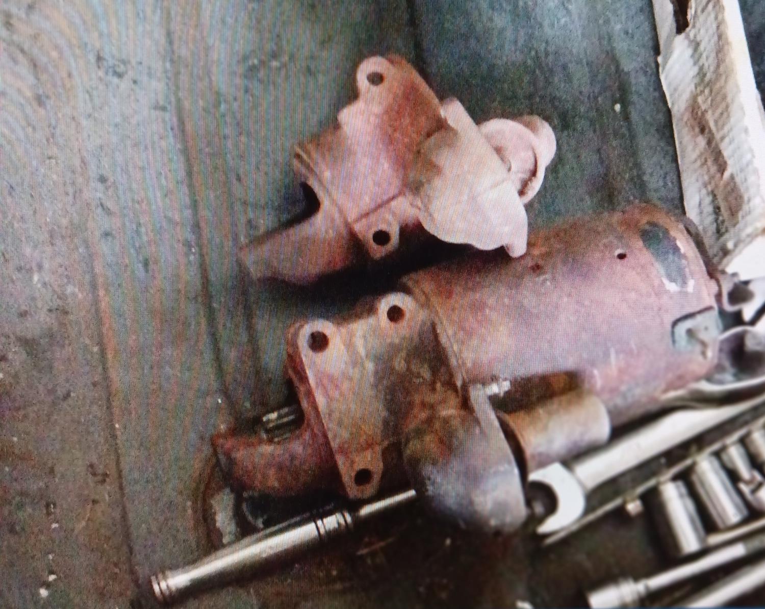

Not exactly what you seek but this is on a third week of Feb Baltimore L78 M22 Chevelle.
Cast nose and motor brush painted Lemans Blue with a brush.
Couple views of the afore mentioned shield.
Tube nut for solenoid attaching point is in console.
Twisted off stud is why the starter- head shield had a photo- op.
