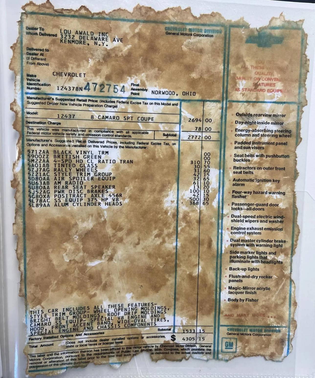

Been restored a while but has big bid already. I was not crazy about the window sticker

That was my first question Bill. Is that WS legit?

I know we don’t want to give out too much information so that the fakers can learn. But, can you please educate me on what you see wrong with this window sticker? I’d like to gain a little knowledge.

I am by no means an expert but if you compare it to some known real ones, I believe it is missing some important numbers.
I also wondered why the type is so clear

My 1969 Pace Car window sticker. The real deal.

Yep a very incorrect reproduction!

Shouldn't the options be listed in Numeric order like TimG's WS?
Amen.

The torn edges are comically consistent all the way around.
