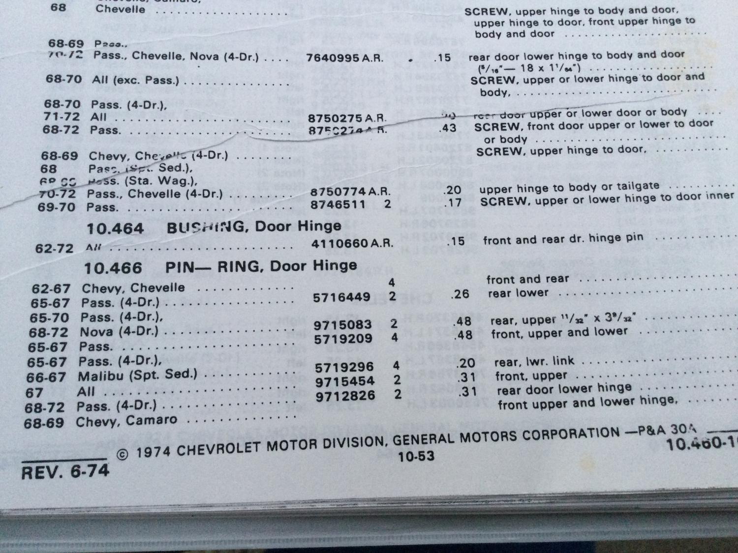

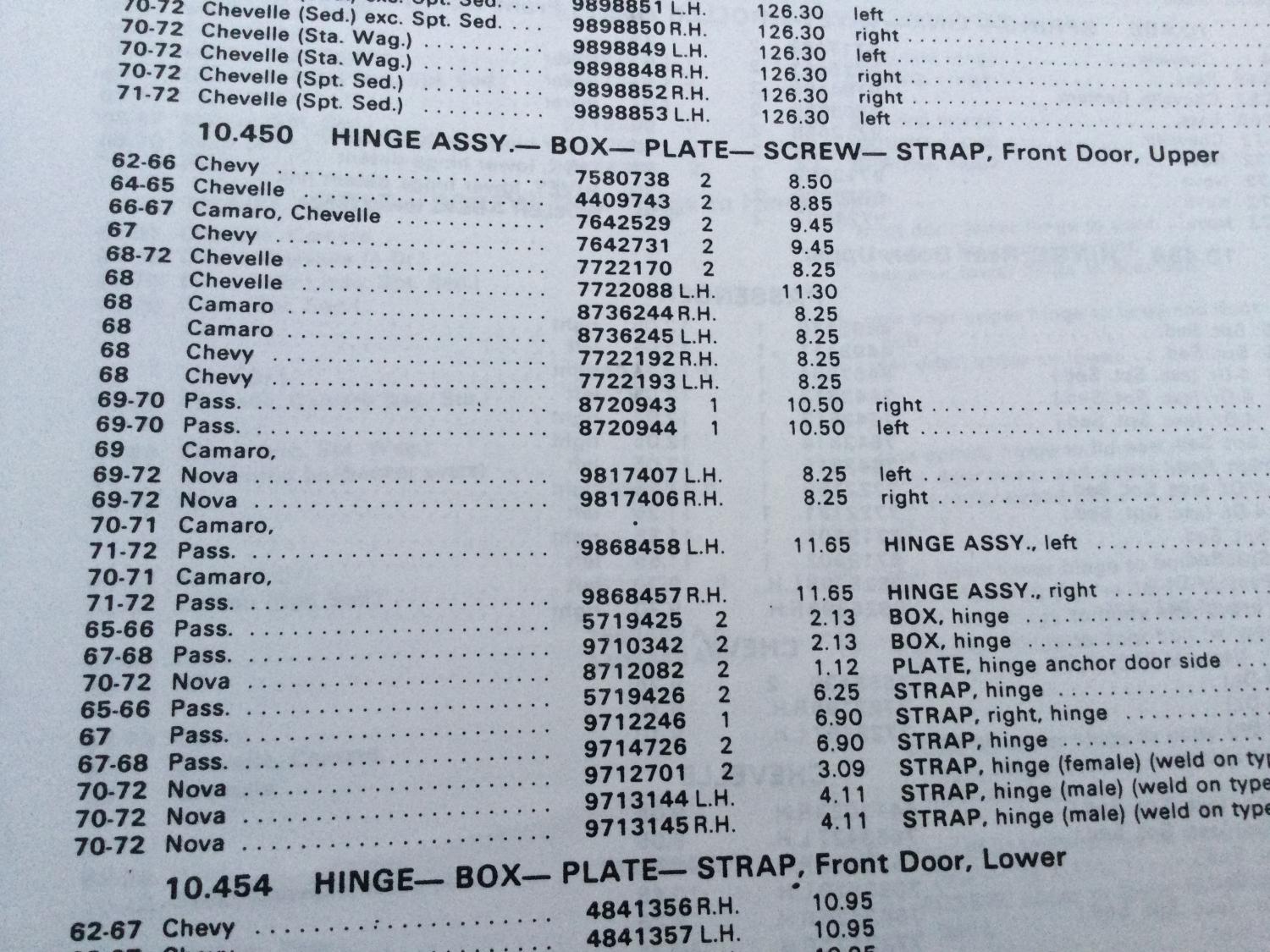

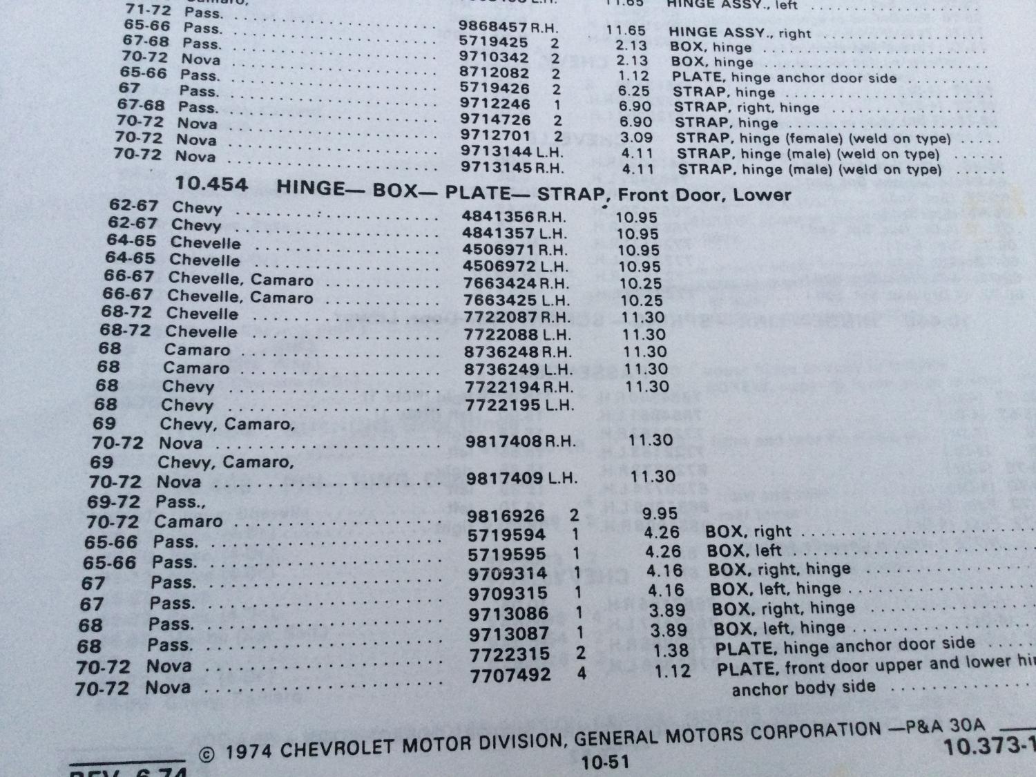

I couldn’t find a kit, but you might be able to find what you need here. Circa 1974 parts book.
