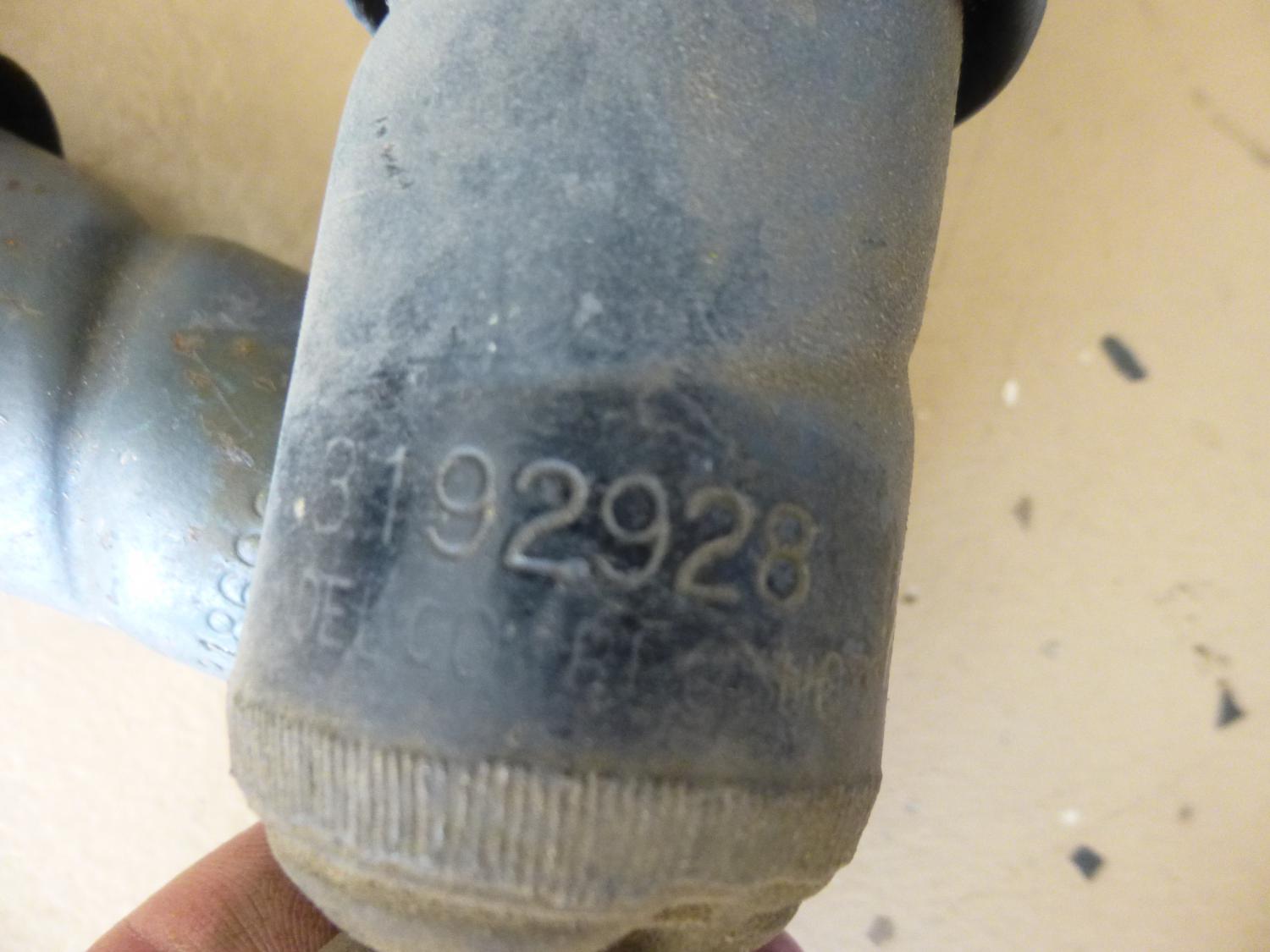

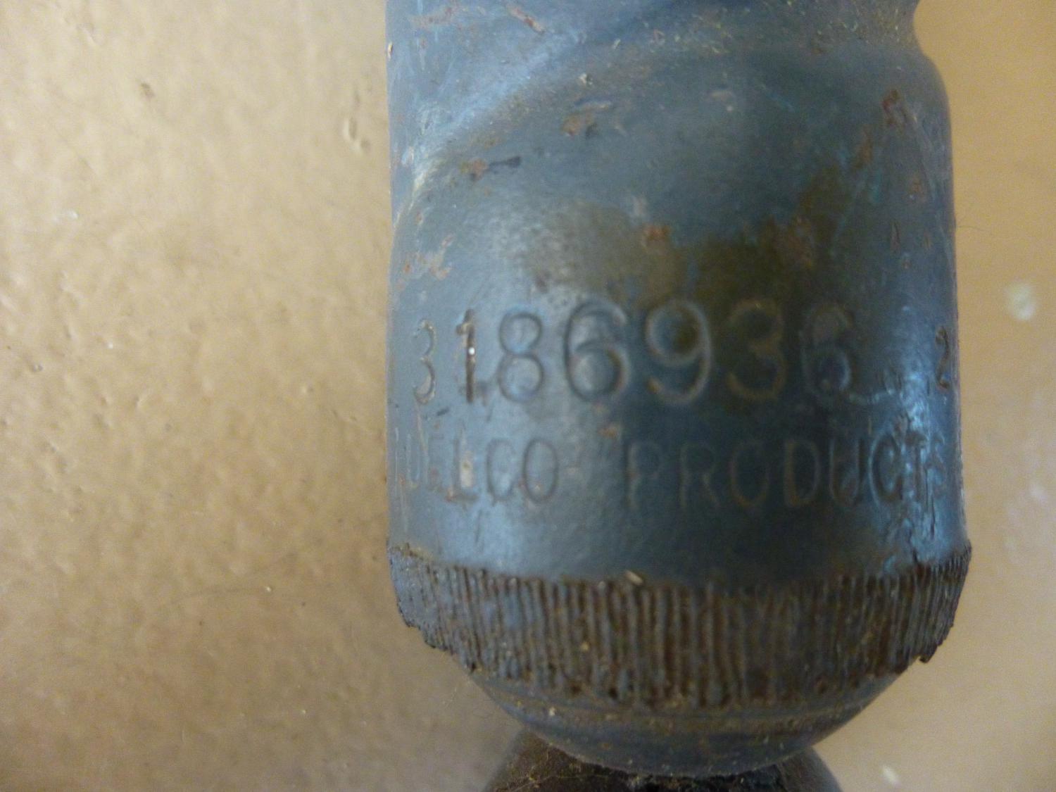

Default Spiral Shock ID??
3186936
3192928
5544777
67 RS/SS 396 Original Drivetrain
70 SS 396 Convertible Original Drivetrain
70 SS 454 LS5 Survivor Original Drivetrain
65 Impala 396/425
65 Triumph TR4 Original Family Owned

Only help I can give is they are not 69 Chevelle SS396 rears.
Hers are 3192430 dated late 68 and have readable LU paper tags on upper shield.
Is there and Delco books out there with this info?
Would like a copy if yes.

You may want to show the other side of top two.
Date is on back side.
Bottom one is May 16 1959.

The 3186936 is dated 262 67
The 3192928 is dated 190 69
I suspect Buick.

According to more than one post on the Corvair forum, 3186936 is Corvair rear.
