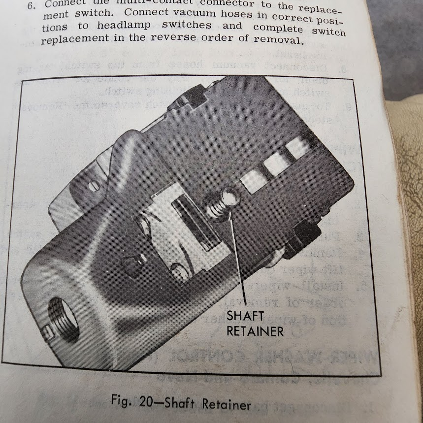

Old 09-08-2024, 07:51 PM
mhm1966 mhm1966 is offline
Join Date: Apr 2012
Posts: 478
Thanks: 542
Thanked 113 Times in 55 Posts
Here is the button to release the knob and shaft.
The Following User Says Thank You to mhm1966 For This Useful Post:
Bill Pritchard (09-08-2024)
