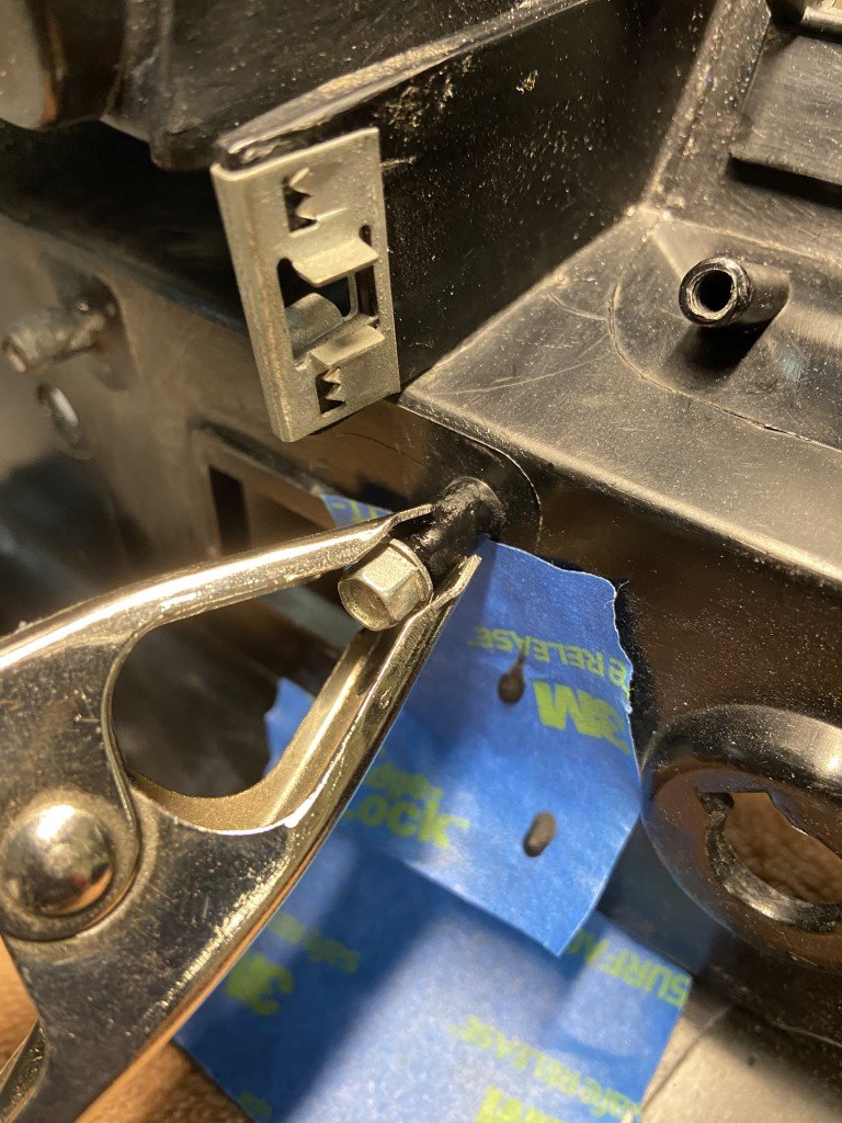

I used Polyvance Plastifix to rebuild the bottom of the radio opening and knobs where it had been cut out. It also worked great on a cracked wiper switch stud, and a missing tab.

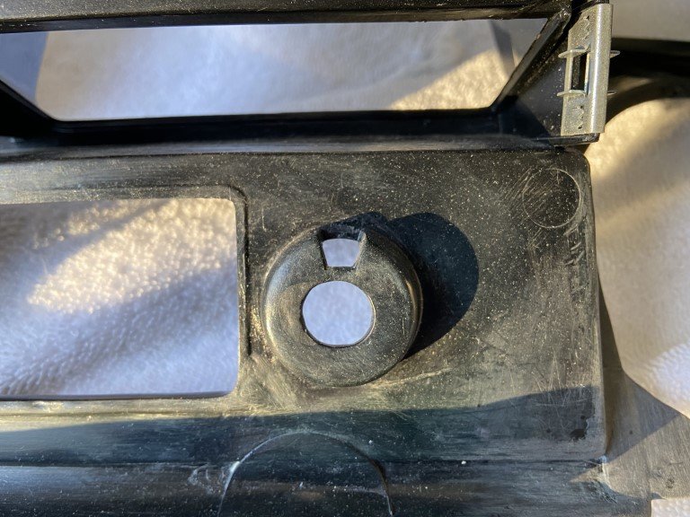

Using the molding putty to rebuild this wallowed out radio knob hole

Name:  Repaired Radio Knob.jpg

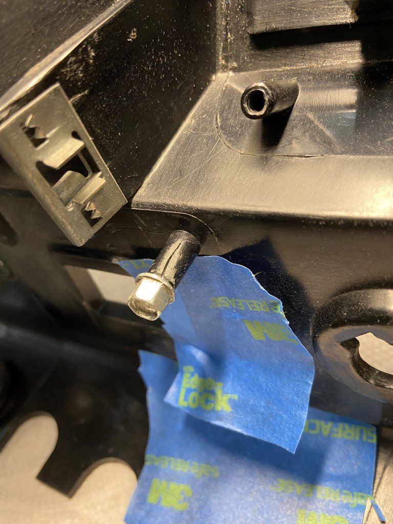

Studs are easy. Platifix can be applied in layers to reinforce these also.
Name:  Stud crack.jpg

Name:  Stud fixed.jpg

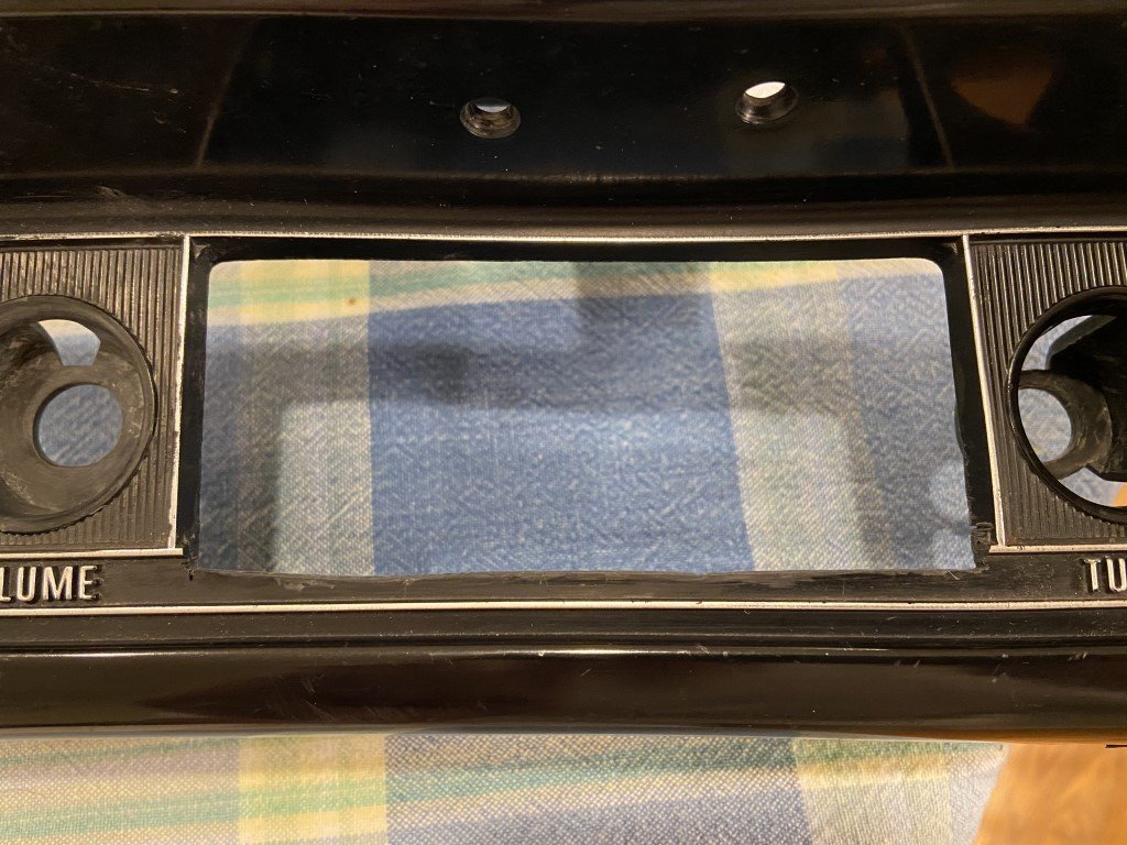

The area where the bottom of the radio opening was cut out was also repaired using the molding putty.
Name:  Radio cutout.jpg
