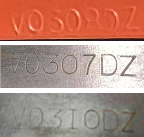

Originally Posted by Lynn View Post
There will be a new flood of 69 Z/28s for sale... real or not, after the hugger orange one sold for $260k.
Here is another hugger orange. You gotta love the pop rivets on the trim tag. Ouch.
https://bringatrailer.com/listing/19...mpaign_2648441
I was waiting for William to call that one out.
Yikes I'm getting a rep...
Look no further than the obviously re-stamped block pad. In 30+ years of logging data, do not have a DZ engine final-assembled Saturday, March 8, 1969. For comparison, here's March 7 and March 10th. Con VIN would have been at the oil filter, different stamp font.

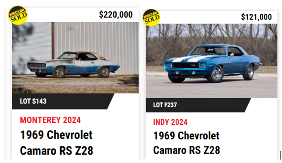

Don't laugh.
Lots of people out there who don't think they need help. The car on the right is a 16k mile completely original survivor.
