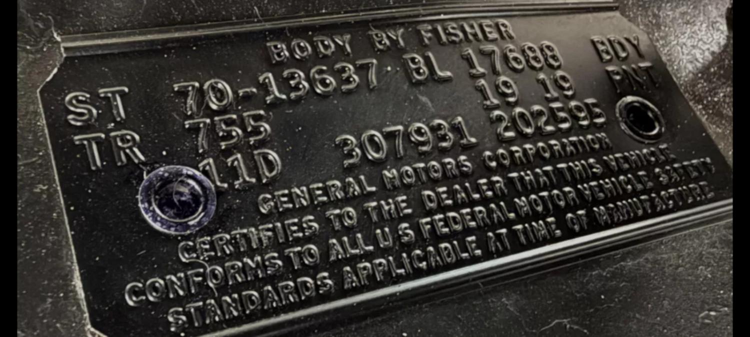

Are they faking chevelle cowl tags too now? This one doesn't look right to me. Opinions please. Thanks

Yes they are and have been for a very long time and unfortunately they are getting better. It could be the camera angle (though I doubt it) but I do not like at least 4 different numerals on that tag.

----As well,,,It's just too crispy to have been on a car for 54 years, IMHO!....Bill S

Isn’t there supposed to be some sealant in the rivets?

Yes, but I have seen tags that I thought were original and the sealant was no longer there.

My '65 GTO (Pontiac Michigan build) does not have sealer on the cowl tag rivets.
