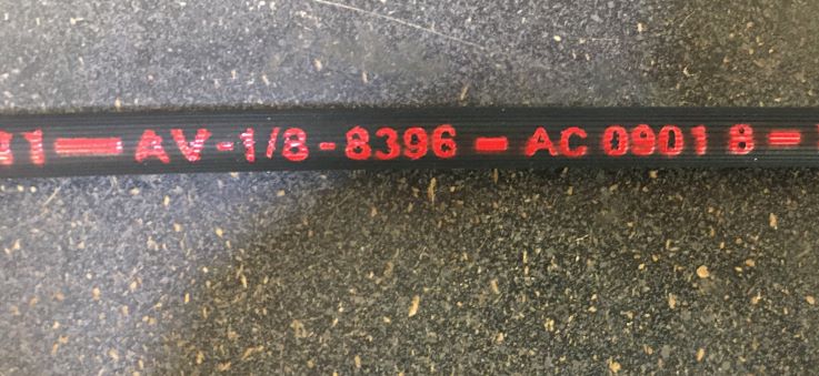

does anybody have nos 69 z28 front brake hoses or does anybody knows who makes the correct hoses.

There are no hoses reproduced or manufactured which look like an original.
DOT regulations require double crimps VS single crimps as the originals had.
I had a set of hoses dated mid 70's which were single crimp however I do not believe they were produced much after that time frame.
Last NOS front disc brake hoses for a 69 F body I saw went for nearly a grand.

Here is my first attempt at stenciling the rear brake hose on my '68 Camaro. Not perfect and I think there's room for improvement but it's a start!

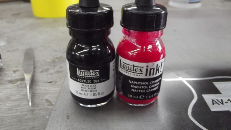

I had issues doing this using paint before and on Grady's Red COPO I switched to a acrylic ink, worked great, took several light coats applied with a Badger airbrush. Used the same ink for the tank stencil, tape pulled off clean.

Sorry I should have posted the Bendix & Wagner hoses look very similar, they are NOT 100% Correct as they have double crimps . They do work OK as far as far as fitment.

What type of stencil tape did you use, Mike? I have a vinyl sign cutter machine available and want to try this. I tried having a custom stamp made and couldn't get enough color saturation. I have an airbrush and would like to try with a stencil.
thanks for any help anyone can provide.
