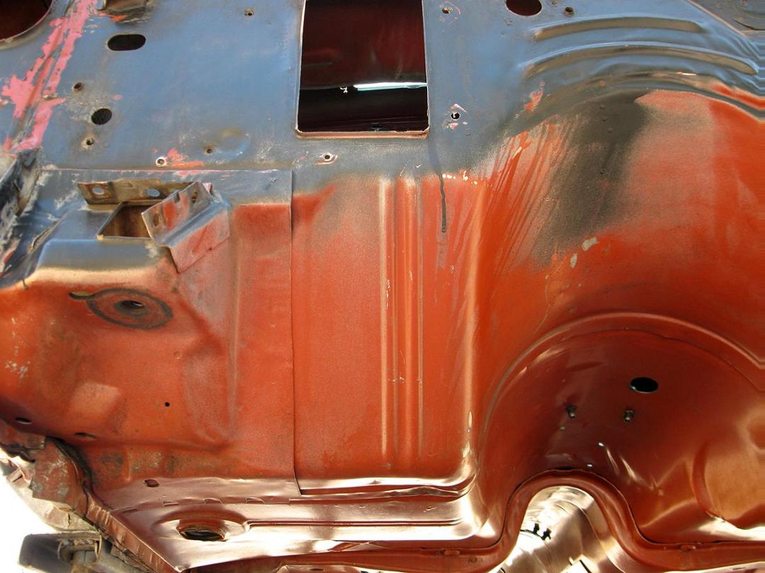

You might want to check with Jack "Jacsey 70Z"
These photos are out of a ton of pics I have collected over the last year and I think they are of Jack's survivor.
Carl

Butch, Not really sure if 100% of body was submerged in Red primer, but judging by interior roof portion, it would appear so..........As with other cars, primer drained out misc holes in floors
Black firewall was painted over red oxide covering verical portion slightly down past where floor angles up to meet firewall........Jack Seymour has picture of his survivor.

Default Re: 70 z correct sub frame & bottom floor pan colo
In the photos of Jack's car you can make out the contrast from the red oxide and the orange overspray on the floors. That's Priceless.
Note the gas tank straps also.

Phil, No question that Jack Seymours's 70 Z-28, ALL of his meticulous cleaning and great pictures, ARE the restoration guide for 70 Camaro's.

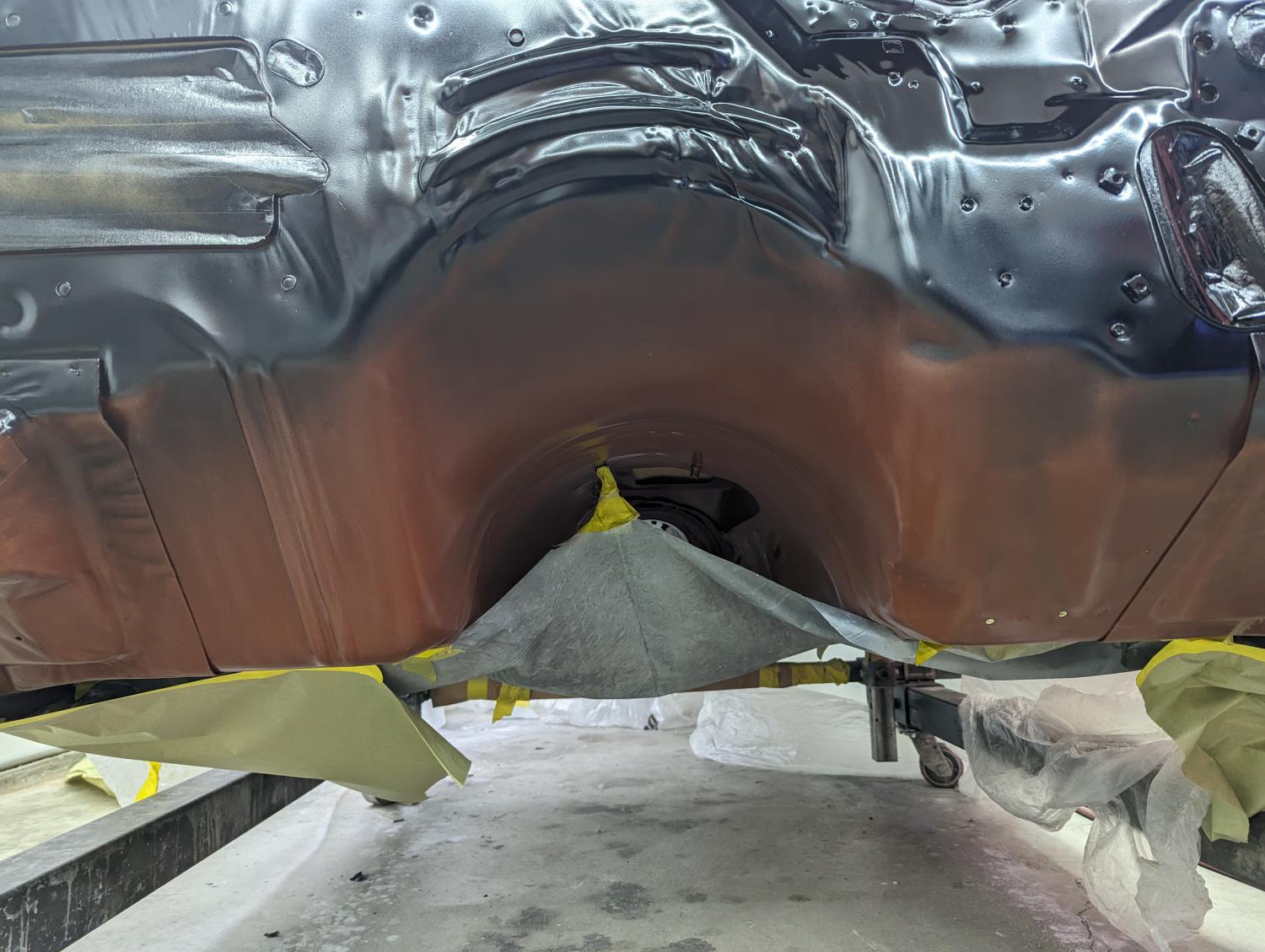

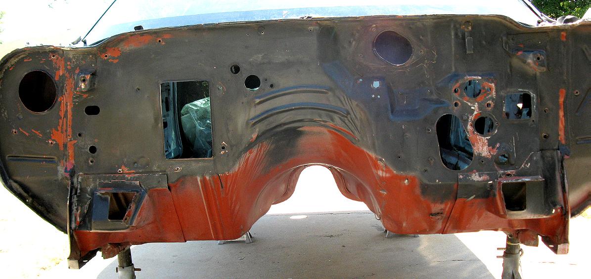

Top pics are Original Firewall Black out
Lower is picture of my Z28 Firewall
Some of us are using SPI (Southern Polyurethane) Red Oxide (blended with Black) to acheive the correct 70 Norwood "red oxide"
