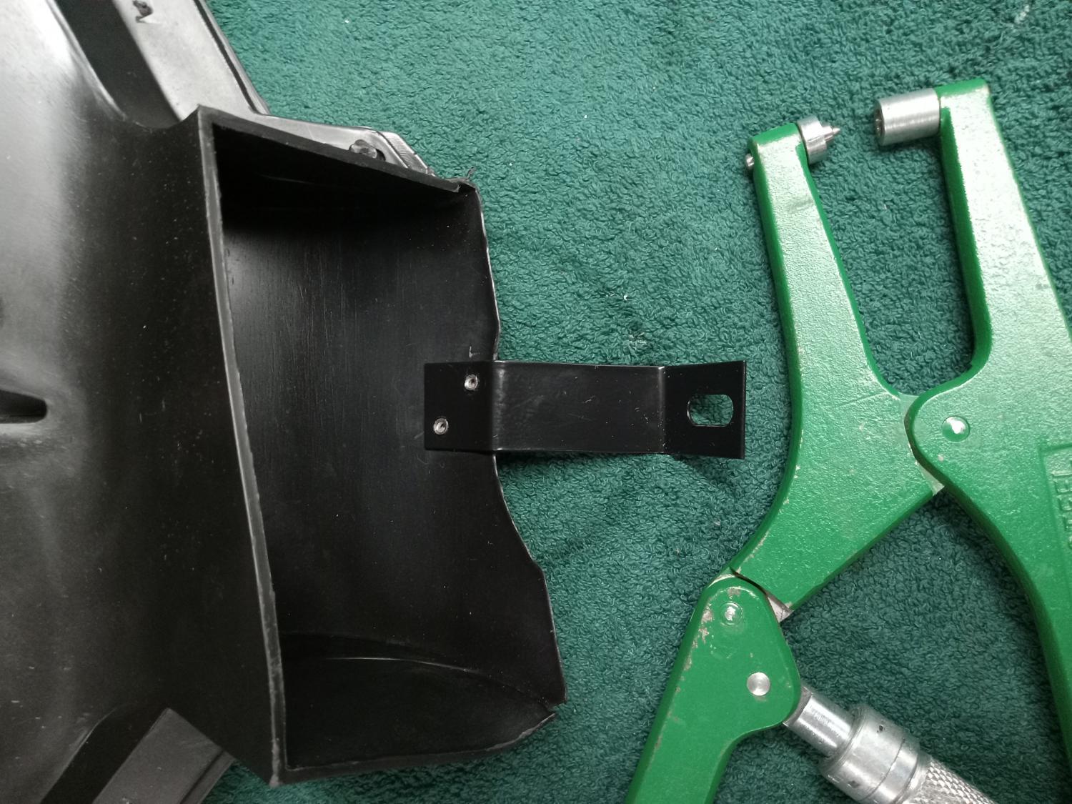

Does anyone know if the rivets and tool are still available in this old thread? I tried sending a message a few days ago through this site, but just checked, and it apparently didn't go through. The Nova Research email has also been disabled according to that site. Thanks

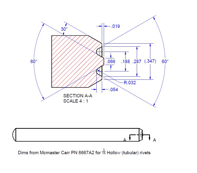

In case you want to "roll your own"
Made mine on a CNC mill using an old transfer punch, but a lathe may work.

I made a tubular rivet tool out of an old punch on a lathe too. I also made a fitting to go in this rivet tool to get to areas where a punch was too big and you couldn't use a hammer to peen over the rivet.

Would someone loan me the above Green Handled Rivet Tool, OR can I send you
my parts to rivet
Need 70 Camaro ashtray rivets & Firewall Gutter / TCS Relay Rivets Installed
