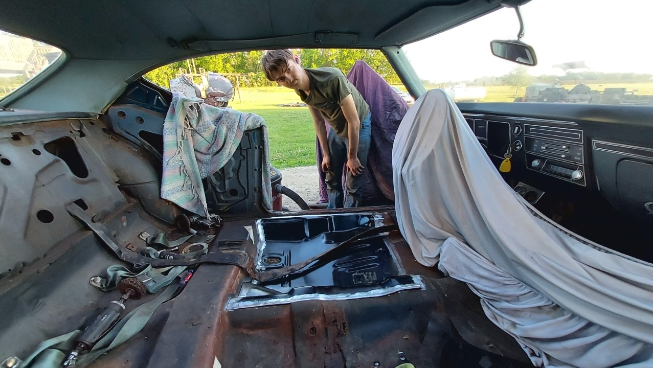

I've owned this car since 2004 and re-assembled it from a basket case to drive "while I was restoring it". It never got past the driver stage until 2 years ago. I, FINALLY, got a 1 piece trunk pan, trunk drops, extension panel, right full quarter and left skin for it. I was just going to do the back half and drive it again.... uh, huh.
The car came from the SF Bay area and was, generally, in good condition, but the salty air caused the typical rust thru at the rear window and the center section of the trunk pan rusted...badly.
I was going to just replace the center pan, but the car was hit on the right rear corner way in the past and the quarter was sectioned on over remnants of the original panel. The tail panel was sectioned in the center of the left tail light opening and the trunk floor/extension was still crumpled and not pulled out properly. This led to the decision to replace the entire trunk floor and "do it right".
The frame rails and left trunk drop are in very nice condition, so I preserved and left them.
The inner wheel houses needed repair on both sides for rust at the floor weld flanges. I had to replace much of the left, while the right only needed sections welded in at the flange location.
After fitting the floor and left inner house, with gauges, to be certain it was centered and square, I cleaned and sprayed galvanizing preservative in the frame rails.
The rails were still galvanized but I had welded up extra holes from previous exhaust mods and drowned the rusty steel shackle mounts in Eastwood converter.
Once all the pieces were ready, the weld flanges got coated with copper weld thru primer and installed.
The floor killed my back and knees from leaning in the trunk. The wheel house required curling up in a fetal position inside the trunk. Good thing I'm not all that big.
