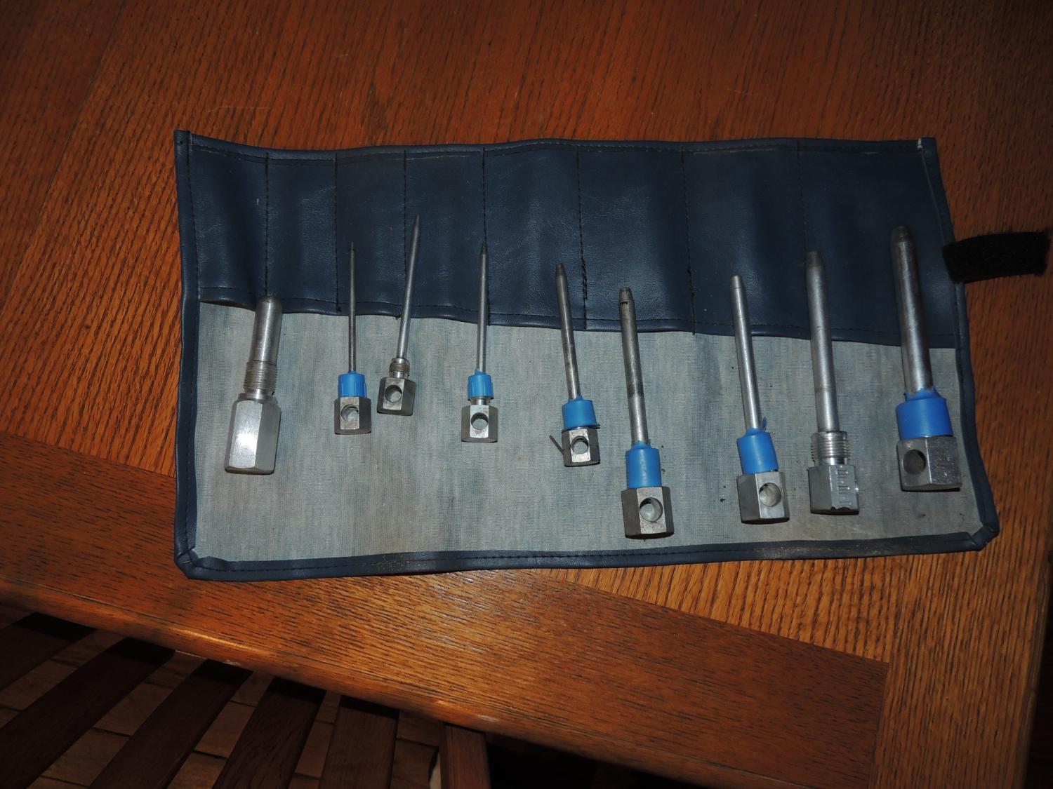

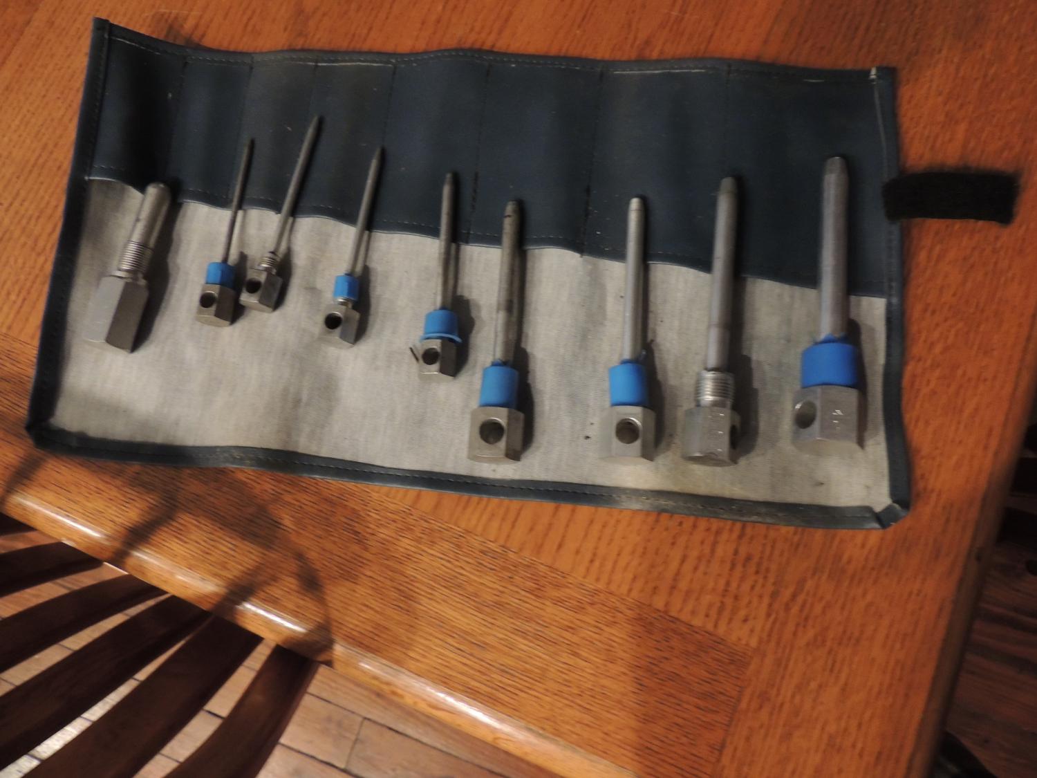

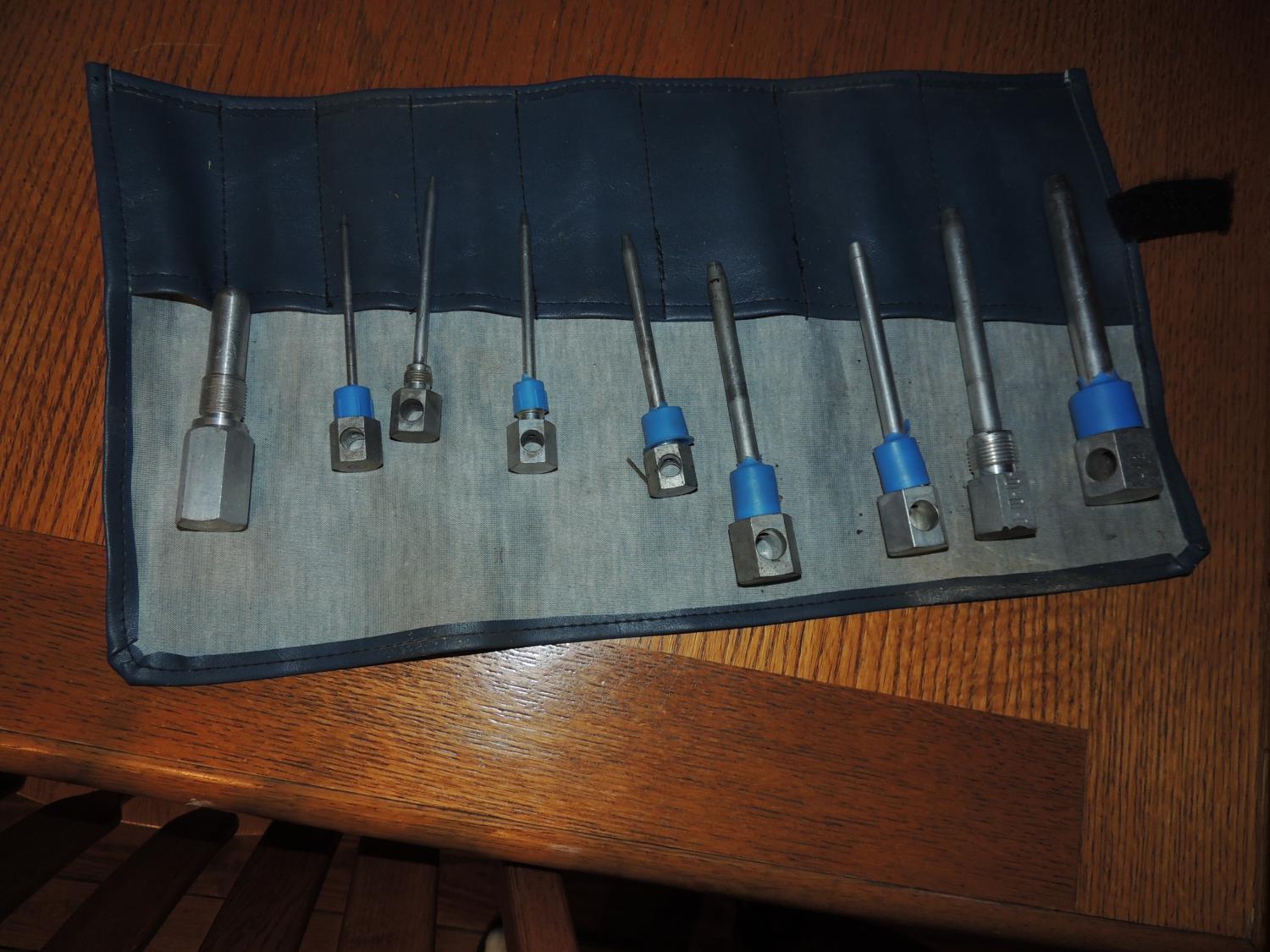

Got these with a bunch of Aircraft tools.
The blue caps cover threads. Guessing they are some kind of probe or sensor.

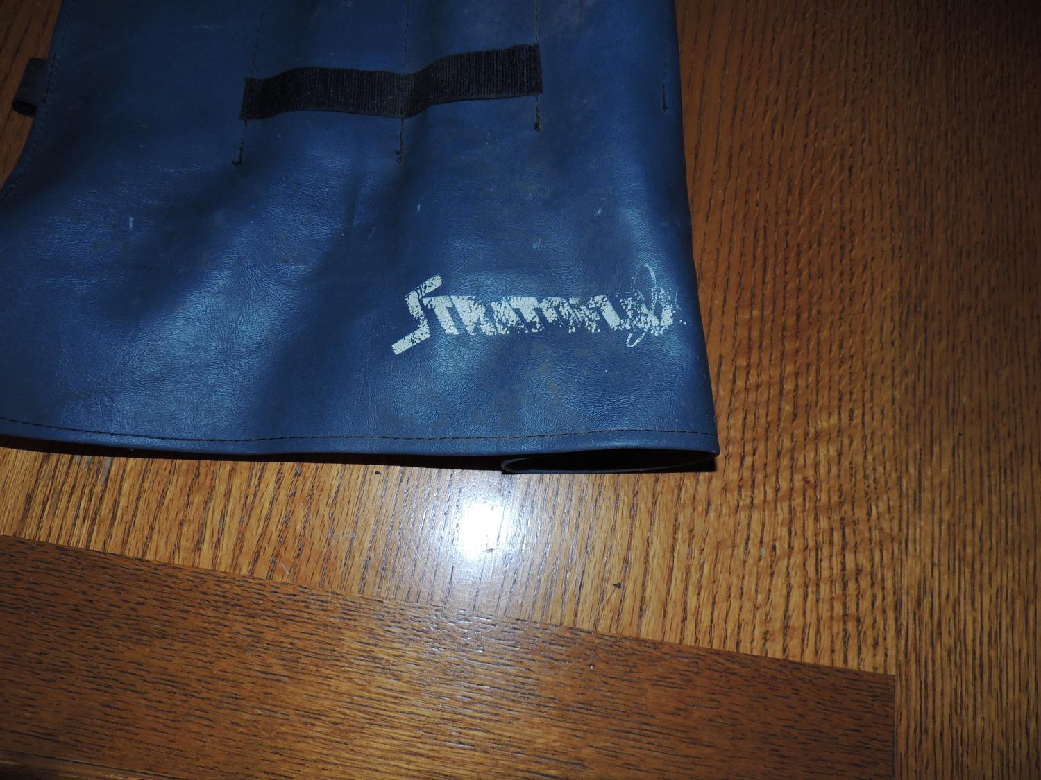

Brand is Stratoflex. Still in business, but could not find anything on the website.
Attachments - The Supercar Registry DSCN8845.jpg DSCN8843.jpg DSCN8842.jpg DSCN8840.jpg

Those are hydraulic hose fitting assembly tools, Lynn. Specific for Stratoflex series 300, Aeroquip 303, and 491 fittings. Looks like for #3,4,5,6,8,10, and maybe 12 line sizes or the like

Found it.
https://www.aircraft-tool.com/detail?id=2701-4
