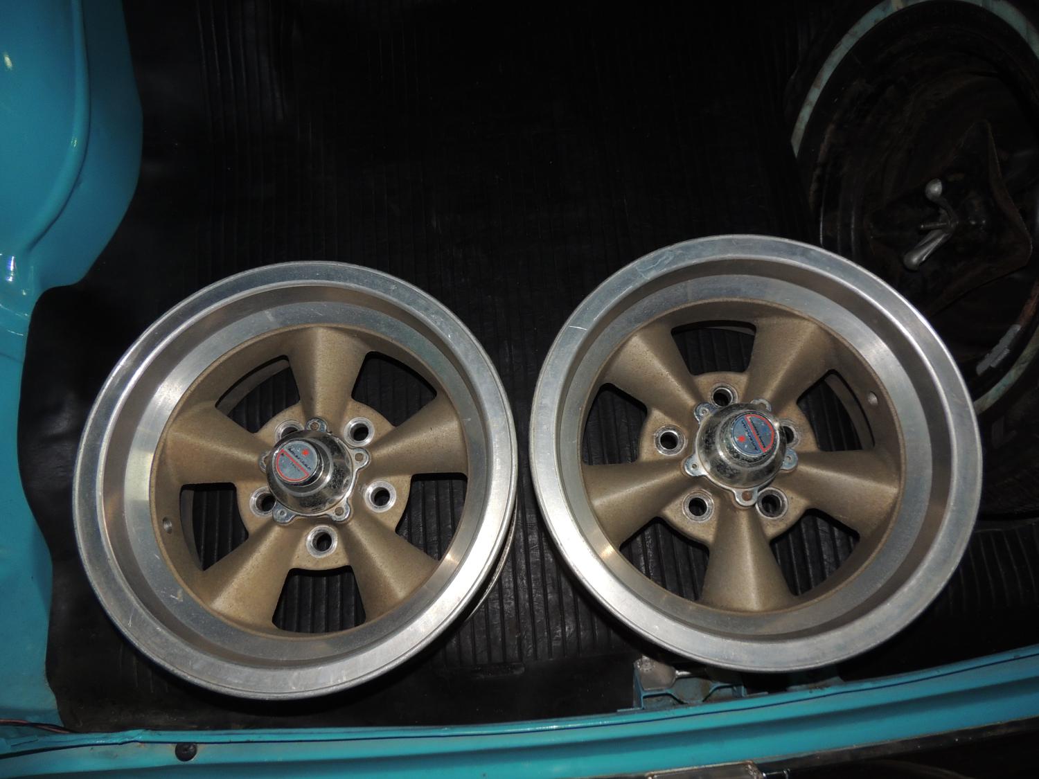

Old school American Racing Torque Thrust wheels on the 57.
9 or 10 of the screws holding on the spinners were broken off in the wheels. I got all of them out on three of the wheels. The fourth wheel still has three broken screws (8 x 32) that I cannot get out.
I used a “rescue bit” on most of the others. But, I am afraid my small rescue bit is now worn out. Rescue bits are not drill bits, but more like little bitty rotary files that cut through almost anything.... until they wear out. I used one to chip out an easy out and a broken drill bit from an old exhaust manifold off my brother’s MG a few years ago. But alas, I think I finally wore it out. They are really expensive ($150 bucks for a set of three if I remember correctly).
Thinking I will affix this last wheel to the drill press, then drill around the three broken screws with a 5/16 hole saw bit. After removing the core, I can tap for a 3/8 standard thread bolt. Will fill the hole with a hardware grade 3/8 bolt, cut it off close to flush, then grind it smooth with the surface of the wheel, then drill and tap for an 8 x 32 screw.
The larger bolt will be completely hidden by the flange on the spinner.
Dumb idea?

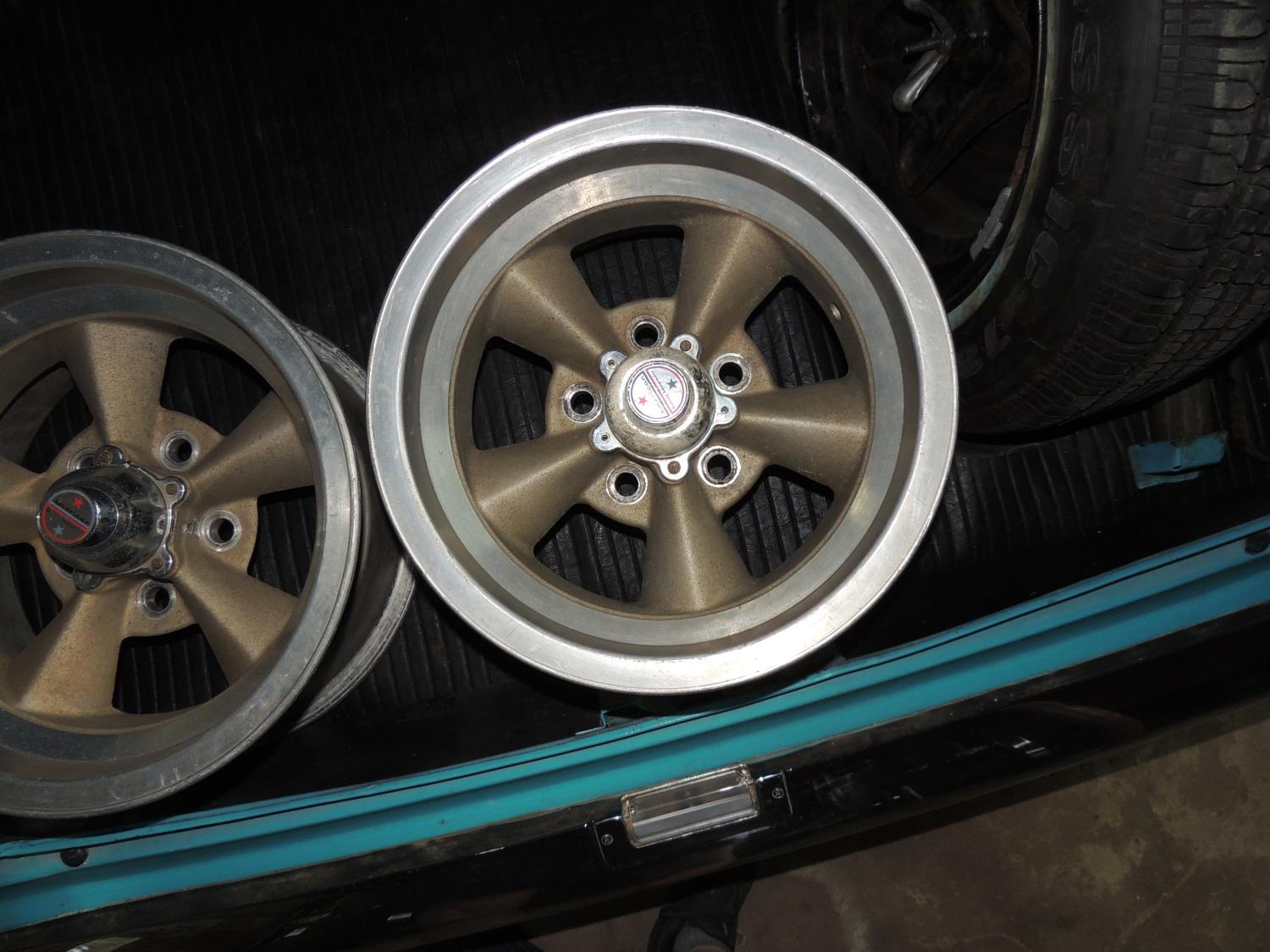

Not even going to repair the wheel with the broken screws. It is a copy of the original torque thrust wheels. The spokes don't match the other three wheels.
I picked up a pair of torque thrust wheels locally that a guy has had in his attic for the last 40 years. Identical size, width and offset as the ones on the car. Really nice condition.
Did American Racing ever paint the centers gold? I am thinking not. Will likely clean all four wheels up and paint them all gray. I need to install the new master cyl and replace the rear wheel cylinders, so will wait until I have all the parts to do the wheels.
I included a photo of one of the wheels that came on the car to show the color. I am thinking that is the color I want for the centers.
