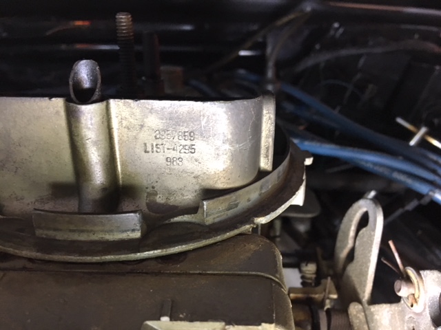

This carb is on a 1969 Camaro I recently purchased. Been on it since the late 1970's, what's the original application?

The 4295 was used on the crossram intake. Nice piece worth some good $

Yep, that a desirable carb with an Aug 69 date

If a Z-28, maybe it was a Crossram car someone swapped intakes and used one of the carbs at hand?
Do you have any history or NCRS Dealer shipped to info yet?

It's on an X44 car, non original engine. Likely just a carb the guy obtained somewhere along the line - lucky for me I guess!
