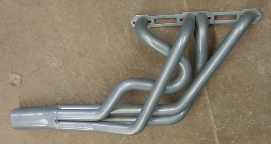

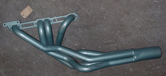

Does anyone have a picture or description of what factory headers look like? I just picked up a Z that has headers with 4 bolt collectors and 3 piece flanges.

Jerry MacNeish's book shows some of the factory headers. If you are saying that the flange where they bolt to the head is separated between the inner and outer ports, then I don't think they are factory headers. I've got a couple of books at home and I'll check after to work to make sure.

According to Jerry's book, the factory headers were built by Thomas and Kustom. Both had flanges that were connected, not 3 part like you describe. The Kustom headers had 4 bolt collectors, the Thomas headers were slip fit and then 3 bolt collector. Here's some pictures of the headers I had Stahl make for me to somewhat duplicate the factory headers.

This is what an NOS set of factory headers looks like. This is the driver's side Bill Thomas style used in '67. Stahl headers do not have the same pipe bends as these but use the same (or similar) style of flange at the cylinder head interface.
