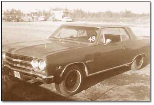

Can someone shed some light on the production window on the Z16's, esp. when the last of them rolled off the line?
Much obliged.

I think production began February 15th,1965 with only 201 made.The first two being built at Baltimore,while the remaining were built at Kansas Leeds plant.

Except for the two Engineering Prototypes, all were built from late Feb thru early April, 1965. The Prototypes are probably included in the 201 total count. I don't believe any big cars or Corvettes received their 396 until well after April.
