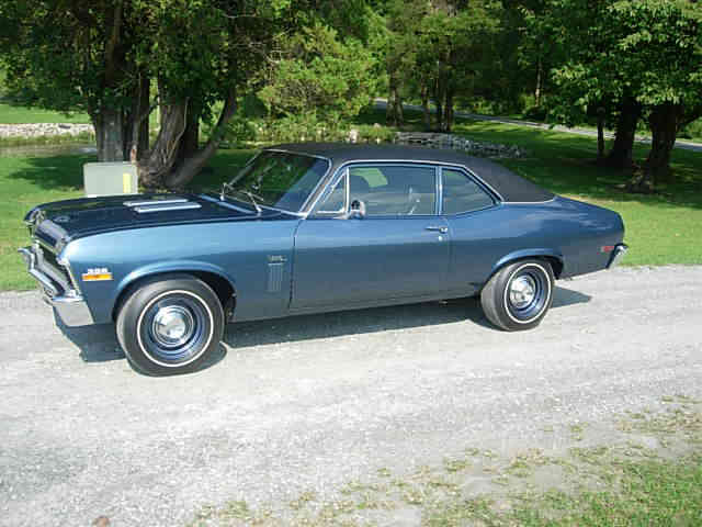

The wheels will always look a little darker than the body with the fathom blue. You have a small area for contrast that doesn't reflect the light as well and some folks don't clear the wheels..just use the base color. will try to post pic.

Beautiful Car Wilma!!! Is that the Marine Corp.s car with XTs ? I have always admired your cars and glad I could get yours and Sullys input also. I would like to see a pic of Sullys car also if possible as I have never seen it. My car is a Fullerton/Anaheim CA. L78 with the Dual Snorkel Air Cleaner and Zero chrome down sides or doors and drip rails. M21 and 3:55s. I have owned 2, 69s and 3, 70s and a 72. Now I'm down to 2, 70s. I'm trying doing a concourse resto on the L78 and appreciate all the info I get from this knowledgable site. I still need to re:up my NNN membership. Thanks again Kim

Thanks for the kind words...Sully's car is getting close to the finish line and should see some day light in 07. Please rejoin NNN..it is a great group of folks!! We have a mini-nats show in orlando the first weekend in March...you are close to that, so why not bring your ride and come down. They ahave the show in old town, kissimmee. good luck with the resto.
