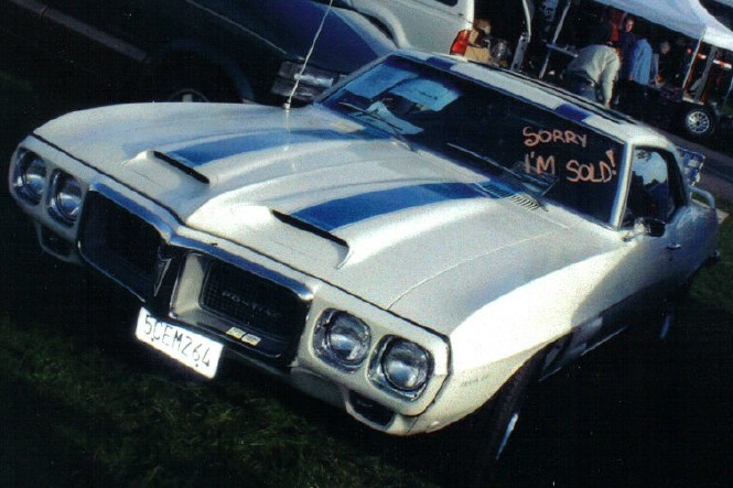

OK guys - I know that the factory didnt offer one, but I am pretty sure there is an 'era-correct' one that was offered aftermarket. Memory escapes - was it Hurst, or some Company from the UK?
Does anyone have the dimensions for it and/or info about it?
Also, has anyone ever seen the trim plate be incorrect showing 12437 versus a 12337 that the vin has and the title shows? The car is an X44 built 09C - vin fits in to the correct sequence, just curious about the body number. Any suggestions on a range for that?

This info begs the question - how do you determine an export car? The speedo is in MPH - dont know that it couldnt have been changed.
The car also has an old style alarm on it. Big horn looking contraption on the drivers fender with a on/off switch behind the side marker light on drivers side fender? Not sure of brand...would that play into any export stuff?
I'll try to attach a pic of the sunroof...

Default Re: 1969 Camaro - Sunroof
In 1969 a Company called Creative industries installed a German made Electric sliding roof for all the major Car companies. They were located arround Detriot. They installed these roofs into the F-body's as well as the Olds Toranado and the Cadilliac Eldo. They also installed these roofs into the Mercury Cougar and the Chrysler A-bodies. I sold a 69 Trans-Am in 04 in original paint that had one installed before being shipped to LA to its original selling dealer. The amount was on the invoice from Ponitac. This car was viewd at Reno 03 and Spring Carlisle 04 By hundreds. We sold the 69 Eliminator at Palm Beach this year that also had one of these roofs. In hindsight I wish I had kept the TA.
