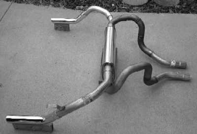

This year I came with a new exhaust system installed, but didn't change anything else. I kept the same engine tune, never even looked at the timing, curve, or jetting. I used the same wheels/tires, same manifolds/smog, same springs/clamps, etc... I did not change my driving style, no sidestepping /stabbing the clutch, or flatshifting. I did remove my tach this year, I shifted by 'feel'. So, the only change was the Pypes = 2.5" mandrel bent, X pipe, sans resonators, crossflow muffler in the stock location and tailpipes exiting in the stock location.
The first run off the trailer on Friday was the best, air was decent as was the traction. The car went:
2.10 in the 60'
13.50 ET
104.11 MPH
That's an improvement of over 7 tenths and 5 mph!! I like Pypes There is more in there if I could drive
