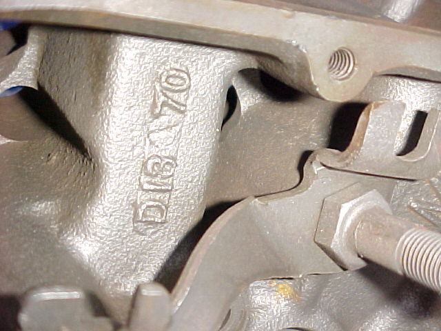

I just picked up a set of Closed chamber big block square port heads.
One is dated D 13 70 ( casting #291 )
and one is dated H 24 70 ( casting # 840 )
..What would the application be for?
....1970 LS6...or 396/375 or both?
Attachments - The Supercar Registry 295127-MVC-020F.JPG 295124-MVC-023F.JPG 295123-MVC-024F.JPG 295122-MVC-021F.JPG
Old 10-16-2007, 03:00 AM
WILMASBOYL78's Avatar
Join Date: Jul 2003
Location: new york
Posts: 8,351
Default Re: bbc head APPLICATION
The 840 heads are the 68-69 closed chamber head for L78/L72 applications...the 291 is the 70 model year for LS6 and L78. I've never seen a 1970 dated 840 head...perhaps it is a service replacement part..??? I'm sure some of the part number gurus will know...so, what you gonna' build???
291s were used on late 69 L-78/L-72. Seems like someone on this site talked about a car with 840 on one side, and 291 on the other.

John,
That '840 with the '70 date would be a service replacement
only - as others here have suggested. Regarding the spark
plug seats, it would be interesting to see if the '70 dated
head has a non-peanut style seat. One more application for
those heads was the L/71 ( so that's L/71, L/72, L/78 )

Here is the photo of the 840 head that I thought was
dated H 24 70 ...or am I misreading it?
...or is it H 24 7

Here is the other side of the same head

here is the 291 head dated D 13 70
