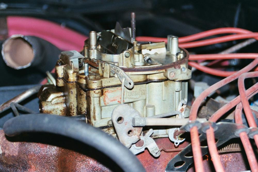

Here's a picture of the carb on my 69 Chevelle SS396 convertible, L35, taken in July 2002 just after I purchased it. At that time the car had just under 20,000 miles on it and was largely untouched. The carb has still never been off the car, but the orange plug wires and chrome loom are long gone
Bill Pritchard
