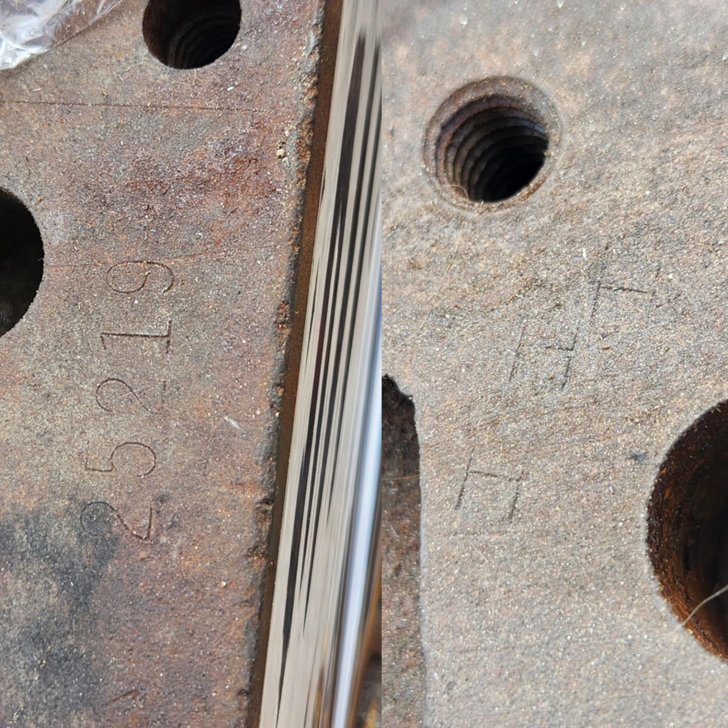

The block has been sent to Ohio for repair and build.
Gary Dyer says he "picked it up at a swapmeet in Indy" many decades ago. He thinks the block froze in the winter causing some cracks in the cylinders. The block is almost .040 over. There were "H" stamps on the oil pan mating surface below the fuel pump and "25219" stamped on the starter mounting surface.
Just keeping the story updated on this block in case it rings a bell for anyone.
