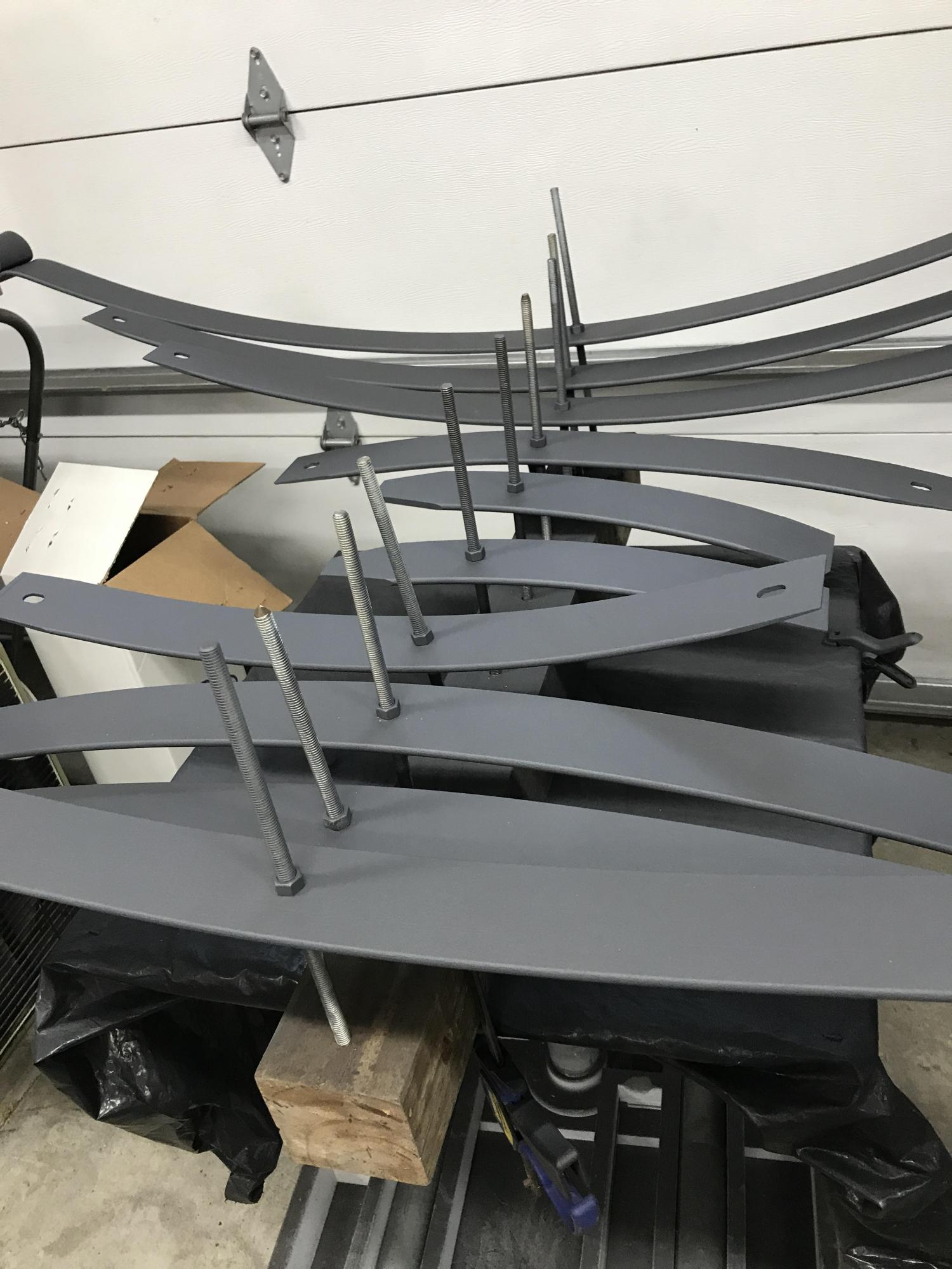

Old 03-18-2025, 01:01 AM
Posts: 2,676
Thanks: 113
Thanked 249 Times in 91 Posts
To The Top..............for more spring suggestions
Only one member has used CERAKOTE (Sniper Gray C-239) on
his multi leaf springs......
