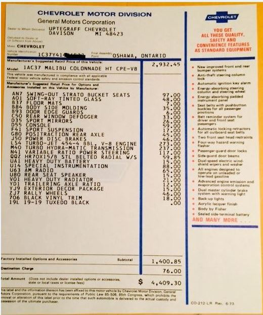

Yes - they came on my '74 Chevelle originally, mounted on 8" wide Corvette rally wheels.

How the heck did you get 15x8 wheels from the factory on a '74 Malibu? 15x7 was the standard RPO rally wheel, right? AS far as I know, Corvette was the only Chevrolet to get a 15x8 from the factory.

<div class="ubbcode-block"><div class="ubbcode-header">Originally Posted By: Keith Seymore</div><div class="ubbcode-body">Yes - they came on my '74 Chevelle originally, mounted on 8&quot; wide Corvette rally wheels.
K
</div></div>
Do you still have this car Keith. That is too cool! 454 Malibu in black. [img]<<GRAEMLIN_URL>>/drool.gif[/img]
