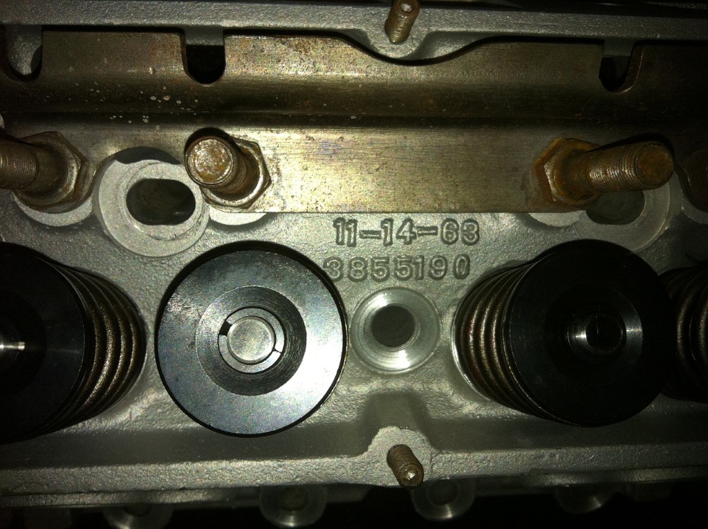

Few people even realize the 63 GS had a 377 cui all aluminum small block with huge side draft webbers...
Is there not a 0 (zero) part number anywhere on it?

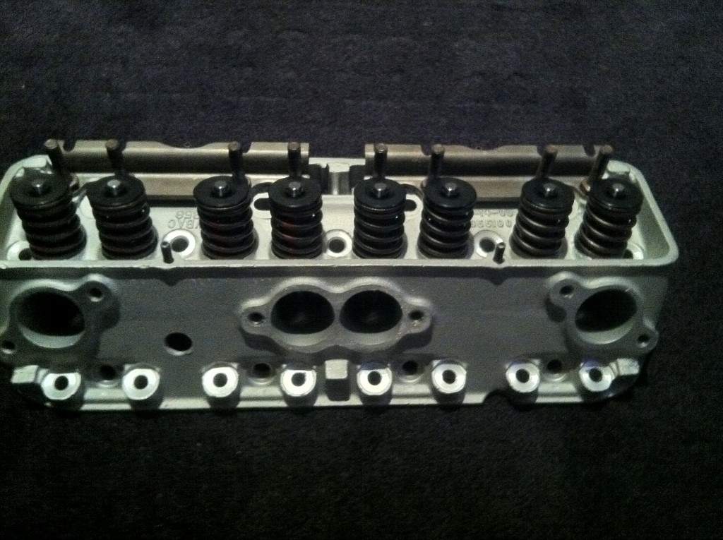

wowww..how cool..I finally just got my Grand Sport heads done this week..and I open this site and see this intake....sure wouldn't mind having this manifold for my motor!!!
Thanks for posting the pics.
Imagine..all aluminum 377 ci in 1963...I wonder what crank/rode, pistons, etc they used then..? Coollllllll stuff!!

Is there not a 0 (zero) part number anywhere on it? </div></div>
No, nothing. ??????????

curiously, the GS heads have a part munber, but do not have a 0- part number...maybe that system started later?? the earliest o- part ive seen was 1965...not that there are not any earlier
