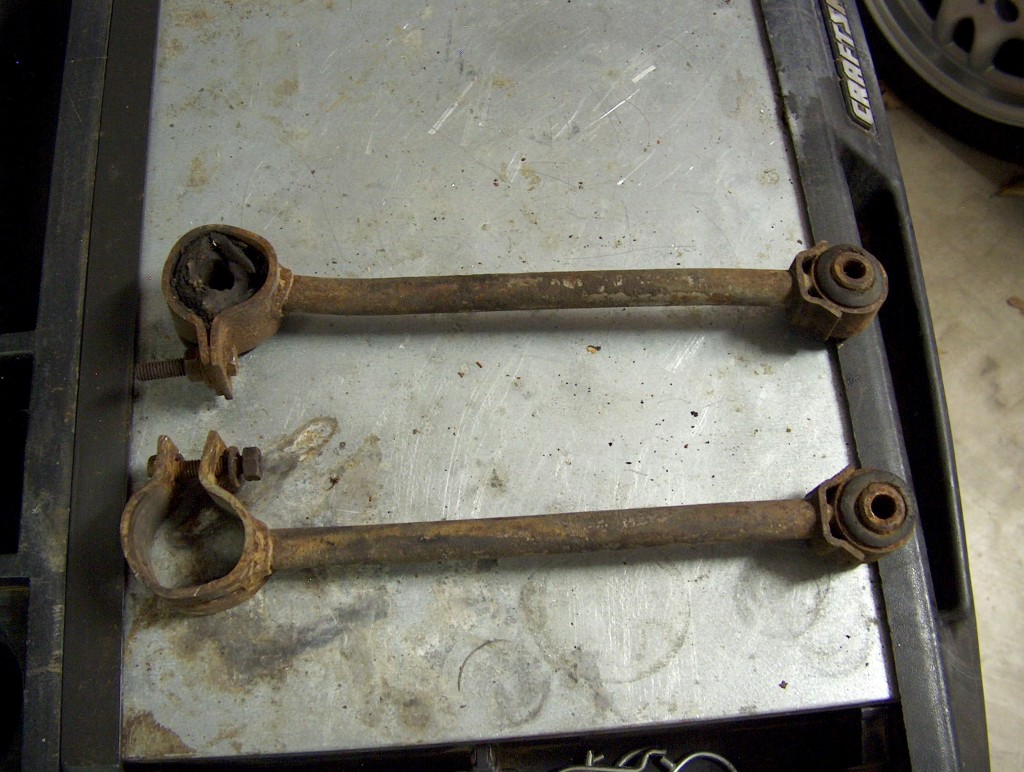

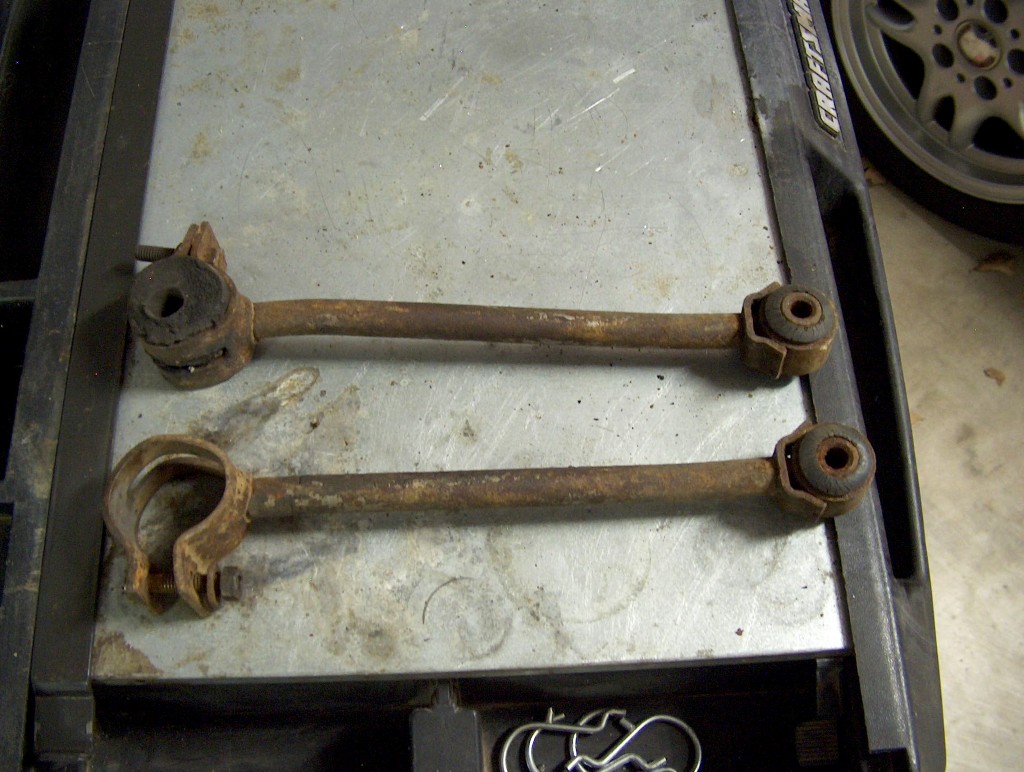

I have a couple of rear sway bars. One is 9/16 inch, the larger one is 5/8. I bought them at a swap meet in the 80’s. Guy said they were optional on 69 Camaros (yeah, I know they weren’t but didn’t know then). He said the big one was for a big block and the smaller one for a small block car.

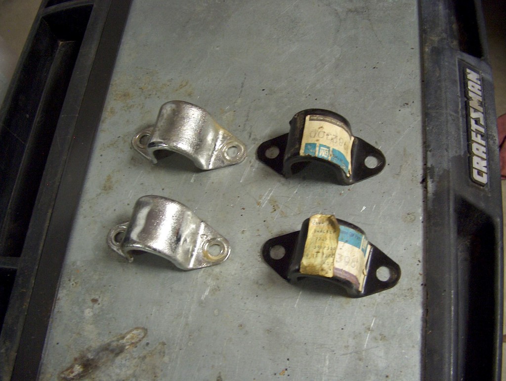

I posted about some NOS weld on brackets that I received with them. I also received the two brackets pictured with the first set of links and a couple of NOS 3983702 brackets, which I understand are for 70, 71 Camaro with F41 suspension, as well as a pair of chromed 3983702 brackets (chromed right over the pitting!).
Anyway, I would really like to know what these two sway bars really fit. The bars are not pitted at all. The links are all four pitted, but not too deeply.
All four rubber pieces are present for each set of links. One piece is really not usable. The rest are.

I believe the 5/8 sway bar fits 70 Nova with F41 suspension based on an expired ebay auction. The 5/8 bar has the smaller rubber bushings on the bar, and goes with the links on the left in my first pic. I also believe the weld on brackets I posted in another thread go with that set up, as well as the black nos brackets that bolt to the lower shock plate. Appears all that is missing are the rubber bushing inserts for the lower mounts.
Apparently the next year, 1971, Chevy changed over to the other set up with the larger bushings (links are in the second picture). I am not sure what the small bolt on brackets in the first picture fit. They fit snugly on either of these sets of links, but I believe the Nova used a weld on bracket. These appear to be bolt on. I bought all of this stuff from the same guy many years ago.
Can anyone confirm my assumption re 70 and 71?
