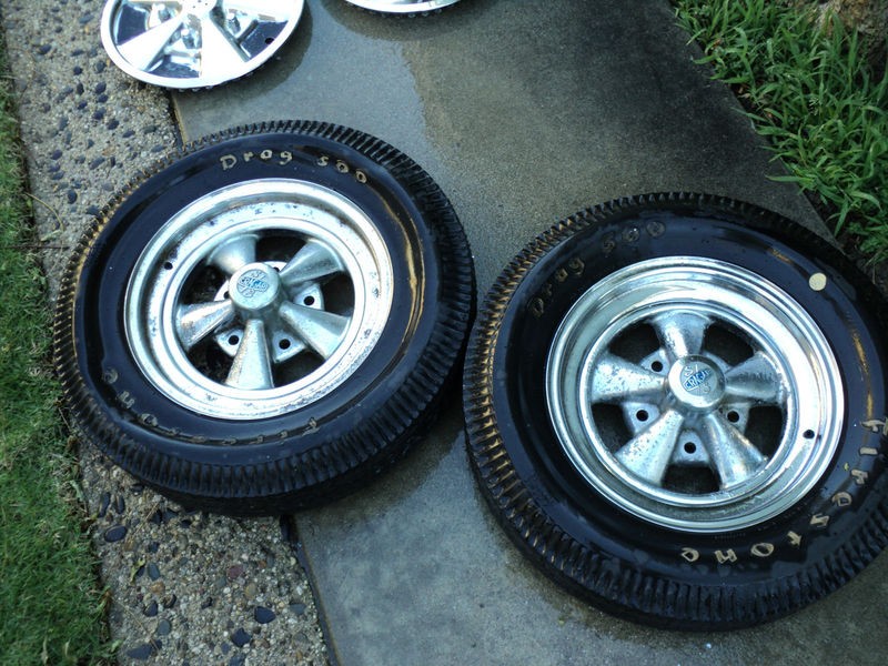

well I got them off of ebay they are a set of skinnies date coded 81, now what is the right size tire for that Day 2 look? I want that really tall look, anyone? Thanks in advance.
john

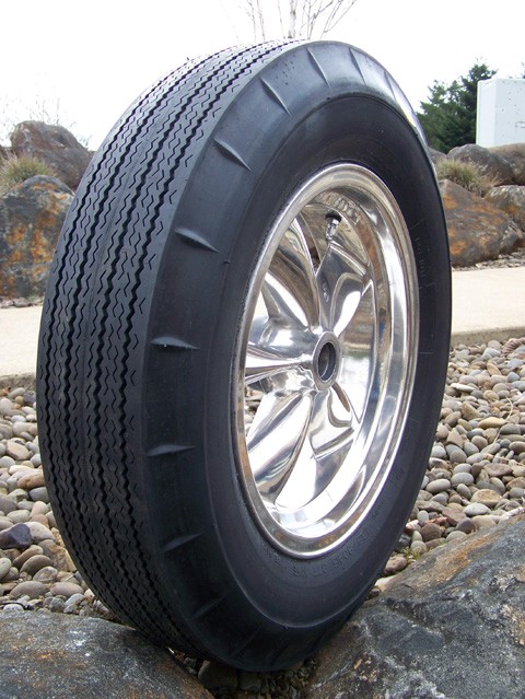

Pro Trac offers two different tires for front runners. One size will bulge quite a bit on a narrow rim. The other size doesn't.
http://www.cokertire.com/brands/pro-...nt-runner.html

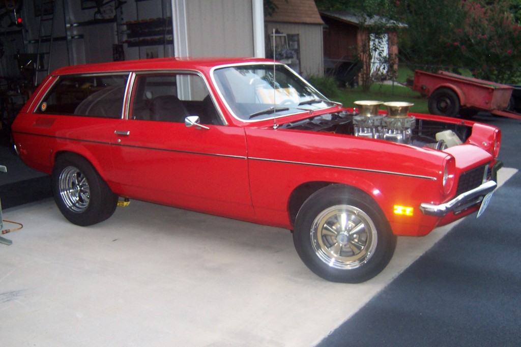

This is the 5.60 and the 235/60-15 Pro Tracs on a Vega. 25.88 on the front and 26.65 on the rear.
Good for a smaller car but not for a Chevelle, etc. IMO.
