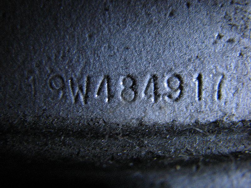

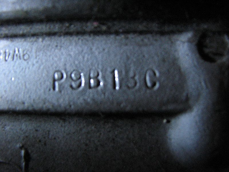

A friend of mine bought this 68 Chevelle recently and is having trouble with the 4-speed in it. Does he have to get it out of the car to determine which trans he has, M20,M21 or M22? He wants to find a replacement first and then take it into the shop.
Stamped on the trans he found: P8E23 and 18W348416
Any help is appreciated.

Muncie from a 1968 Nova. I don't believe you can tell M20/21/22 in '68 unless you pull the trans and count the grooves on the input shaft (2=M20, 1=M21, 0=M22)
