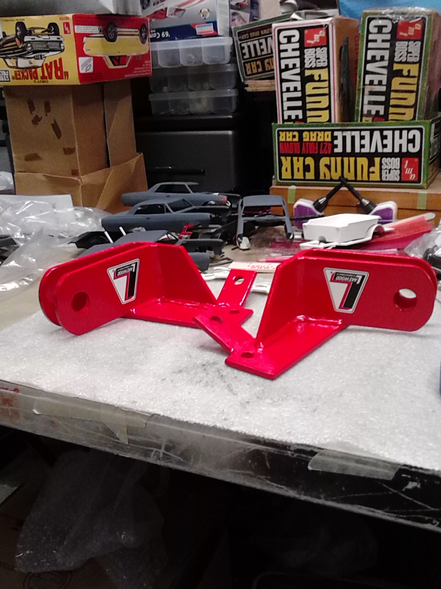

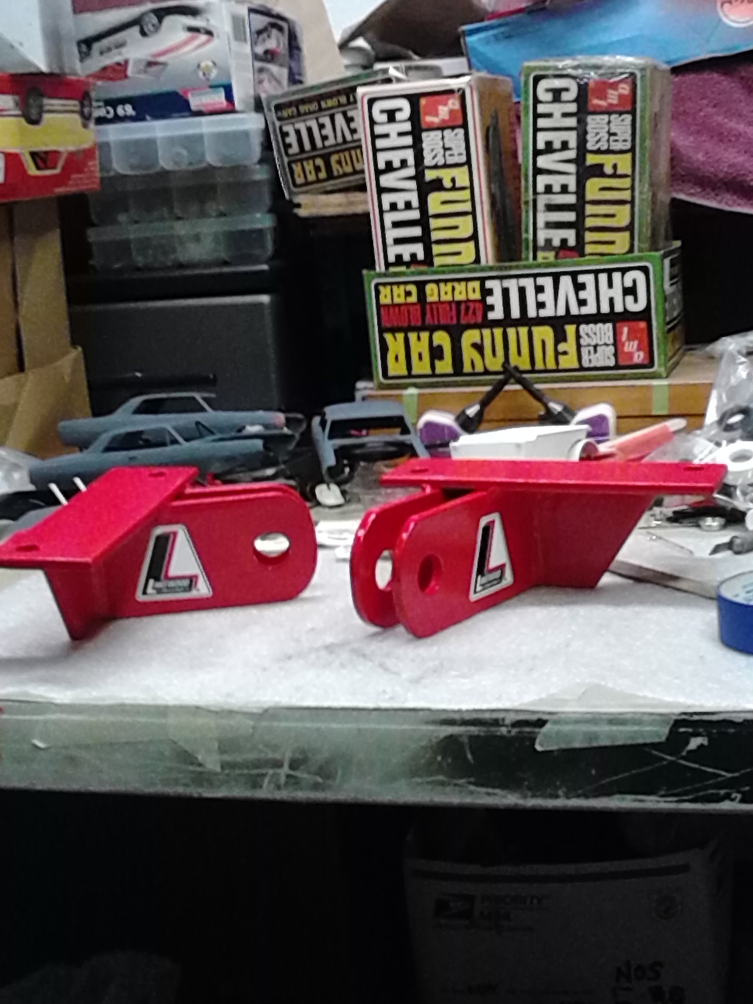

Completed Tow Tabs as Lakewoods to compliment all the other Lakewood Day 2 Add-ons:
3 point loop roll bar
Scatter shield n louvered block saver
Drive shaft loop
Drag Shocks front & rear
U-Joints
Traction Action. (Grumpy Bars)
J bolt kit
Motor Mounts and Trans mnt.
& some miscellaneous items.
Fly eye too....
Day Two Specialties /High Quality Muscle Car Parts.

Those are Paul's Tow tabs BTW.

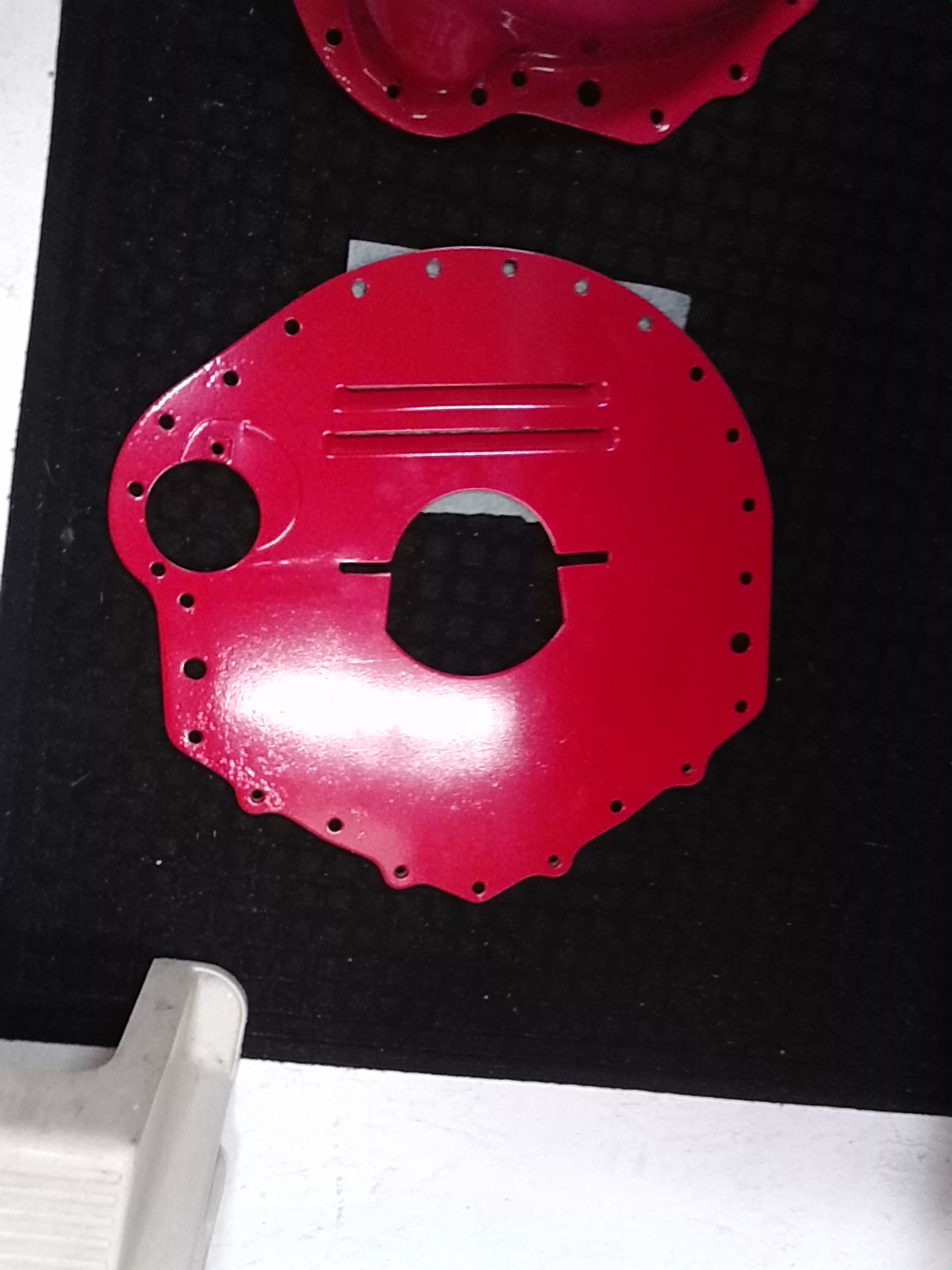

Question: When did Lakewood stop punching louvers in the block plates?

The Louvered plates were superceded by a 3 Hole one about 1970 + /-.
If you notice on my plate it has a non-round Crank flange hole ,,,which the SBC 's had ....when the 427 &amp; 396 became common place they revamped them to accept the BBC &amp; LT 1 type flanges

The Scatter Shield is old because of the HOLE in the bottom that is used for clutch adjustment,I don't know if the hole could pass tech now.

Correct, the Scatter shield is Pre 1971-72 ?
The sight/gauge hole was outlawed by NHRA &amp; the other sanctioned bodies.
Reason #1
The hole could be weak point for major exploded clutch, p-plate &amp; flywheel shards from with in to penetrate the hole and split open the bell.
#2 A minor disc or P plate failure, even flywheel teeth from exiting through the hole laying debris on the track.
#3 Remote,yet realistict, fluids leaking onto the track/ racing surface.
