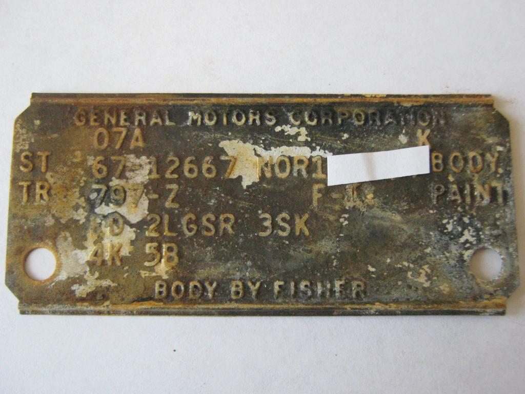

http://www.ebay.com/itm/1967-Camaro-...-/252740533318 only 5,000.00
Old 01-26-2017, 10:45 PM
rare4k rare4k is offline
Join Date: Sep 2007
Location: Annaoplis MD.
Posts: 886
Thanked 13 Times in 10 Posts
Default Re: Convertible L78 tag
07A K
67 12667 nor 1XXXXX
797-Z F-1
FD 2LGSR 3 SK
4K 5B

He says he still has original motor and that it's in bad shape from sitting out outside

This is the klown who screwed Matt over on the 3130 carburetor.
Tag is a repo IMHO

dvss1, what about the tag says it's repo IYO?

That should be ED not FD in group 1. And I agree its a fake tag compared to others I have in the July time frame but I am not expert so take it with a grain of salt..

Looks like an E when you expand the picture.

fake, i have issues with all the fonts.

Characters look flat on the surface, not rounded, almost as if they were filed/sanded down.

He spent all that time filing the freshly stamped digits and faux weathering the tag, he forgot to make some fake rivet impressions on the perfectly flat metal tag blank. [img]<<GRAEMLIN_URL>>/rolleyes.gif[/img]
