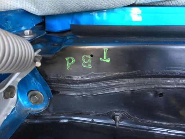

Can anyone recommend a supplier that produces the correct PTB stamp kits? There are a couple of suppliers that offer them but the stamp size appears to be different.

I used this green ink worked well e bay # 331798697742

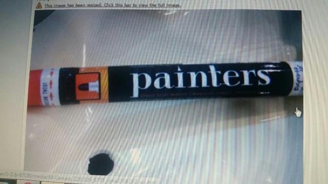

Chick used a marker pen he got at walmart and coated the stamp in the team camaro thread. Seemed to be a good way to control how much paint was on the stamp and looked great.
