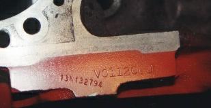

Does anyone know if the vin on a 74 camaro is on the pad of the block or stamped by the oil filter?

I think the vin on the oil filter was 69 cars, but here's an example of a 73. Hope it helps

Yep, that's exactly where the '74s are stamped. Just like the '73s. Behind and below the alternator on the engine pad in front of the passenger side head.

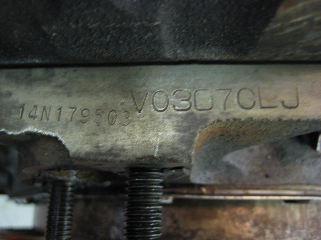

I'm sure all were stamped on the front pad. Here's my 74 z28 stamping
