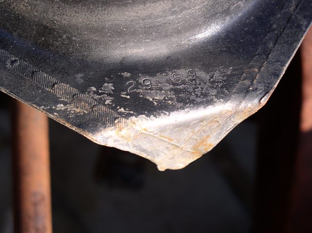

I'm looking for a 1969 Camaro/Firebird gas tank dated 2 70. Thank you, Joe

I don't think you're going to find and original tank for a 69 with that date my 69Z was one of the last ones made 11A and the date stamped on it was 9 9

You might want to read this report...Joe

Here's a picture. Driver's side front facing down...Joe

The one out of my 08A built 69 Z was dated 1 70.
GM considered August the first month in the next year's model build. True, most parts are dated the actual year made, gas tanks are an exception.

I will have to look at mine after I got all of the undercoating off it had a big ink stamp with the name of the steel company and the date
My original. 08D 69. 2 70
-Dave

Good picture Dave. Now I just need to find somebody that's willing to part with theirs, hint hint...Joe
