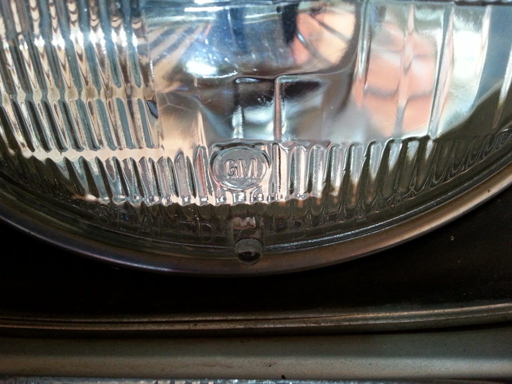

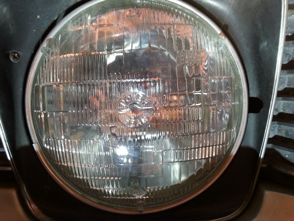

Looking for T3 headlamps for my 1969 Nova SS
where to buy them?
Are the repops close to originals? what are the differences?
TIA

You can buy them at Lectric Limited. The difference between originals and repops, if you look in the upper corner of the bulb the repops have a very small "DOT" running vertical. The originals do not. Others very well may have noticed other differences. I can tell you from experience, putting the originals in can be a PITA. You install one and in a week they burnout. They are also very dim. But if you are showing the car and not driving at night go for it.

my 69 04c nova has power beam headlamps,what's in yours now?

One is a Wagner Sealed Beam and one is a TS sealed beam.
