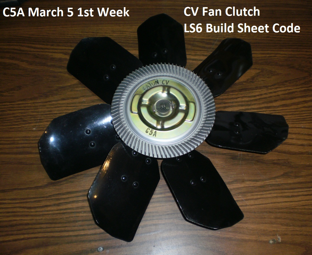

Hey Fred hope this helps. It's a CV Clutch fan but not sure if CZ carried the same dates.
My former LS6 had this on an 04C cowl tagged SS.

Thank you !
Even though its a 1970 fan, it falls within the expected range of 5-6 weeks
Anyone else have something to compare for 69 L78/L72? Eaton CZ?
