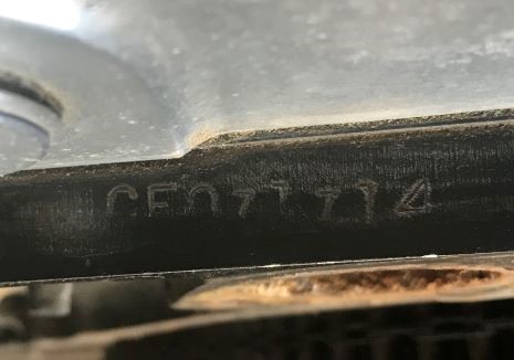

Hi, I have an opportunity to buy two 427s and need some info. I've done searching through the site but still have more questions.
First 427 is definitely an L-88. Long block hasn't been apart. The pan was changed and confirmed to be 4 bolt mains. Block casting number is 3963512, heads are aluminum snowflake casting numbers 919842, and there is a block stamping on the pad in front of the head. The bottom 1/3 of the letters/numbers are illegible, but I believe it reads CE071714. The 7's sit a little lower than the 1s and the 4. The current owner indicated it came out of a 68 or 69 Camaro and that it was running when pulled. Currently no intake. Unfortunately I didn't get a picture of the date stamps on block or heads. I understand CE is crate engine, but any thoughts on the numbers after that? He asked me to make an offer on this one. I don't know what a fair price is for it.
Second 427 is a 4 bolt block and steel crank only. I wasn't able to get to it to look at casting numbers, but both have been machined, oiled, wrapped, and ready to assemble. He's asking $1100 for this one.
Any thoughts or information on the market for these would be great. Thanks!
Attachments - The Supercar Registry IMG_5907.JPG IMG_5905.JPG 427 CE Number.jpg

The first character will designate the GM Division which produced the assembly.This does NOT stand for COUNTER or CRATE.
C=Chevrolet
L=Oldsmobile
K=Cadillac
B=Buick
P=Pontiac
The second character will indicate the type of unit.
E=Engine
T=Transmission
The digit following the letter will designate the year it was put into service.
8=1968
9=1969
0=1970
1=1971
2=1972
The last 5 digits specify the service replacement unit sequence number.
If the allotted series of unit sequence numbers is exhausted,the plant will start back at the beginning of the numbers again,but this time prefixing it with the letter A to indicate that.
Your example: CE071714
C=Chevrolet
E=Engine
0=1970
71714=block replacement sequence number

Thanks for all the replies. Mr70, great info. Very helpful! I'm working on getting the casting dates and will post them when I do. Here is the block casting number and pad number.
Old 11-02-2018, 11:41 PM
Posts: 20,900
Thanked 3,496 Times in 1,419 Posts
Yours was numbered fairly late too.
Tonawanda started numbering @ 50000 and went up to 79999 during that period.
