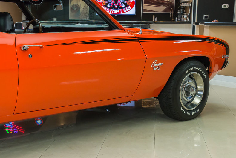

Has anyone ever had G70x15's on a 1969 Camaro, preferably on factory Rallye Wheels? If so, any tire rub problems? Does anyone have a pic of a 1969 Camaro with G70x15's? I thought for sure one would pop up on a generic Google search, but no luck there either.
Kicking around the idea of the new FR70x15 Firestone radial redlines, just curious if anyone has ever had G70x15's on a 69 Camaro or if F70x15's are as big as the wheelwells will handle.
Edit : Metric equivalent of G70x15 is P225/70R15, so if anyone has run this size on a 69 Camaro, factory 15x7 Rallye rims, please chime in.

Thank you Lynn! Interesting, I've found a few pics online of examples wearing P225/70R15, and none of them seem to have wheelwell trim. Wonder if it's that close up front?
Found a couple '69 Firebirds too, either without wheelwell trim, on in one example the wheelwell trim is missing (as in a gap) right at the peak of the front wheelwell, which tells me they had tire rub.
Perhaps the F70x15 (or P225/70R15) is the safest bet....

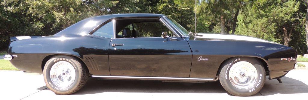

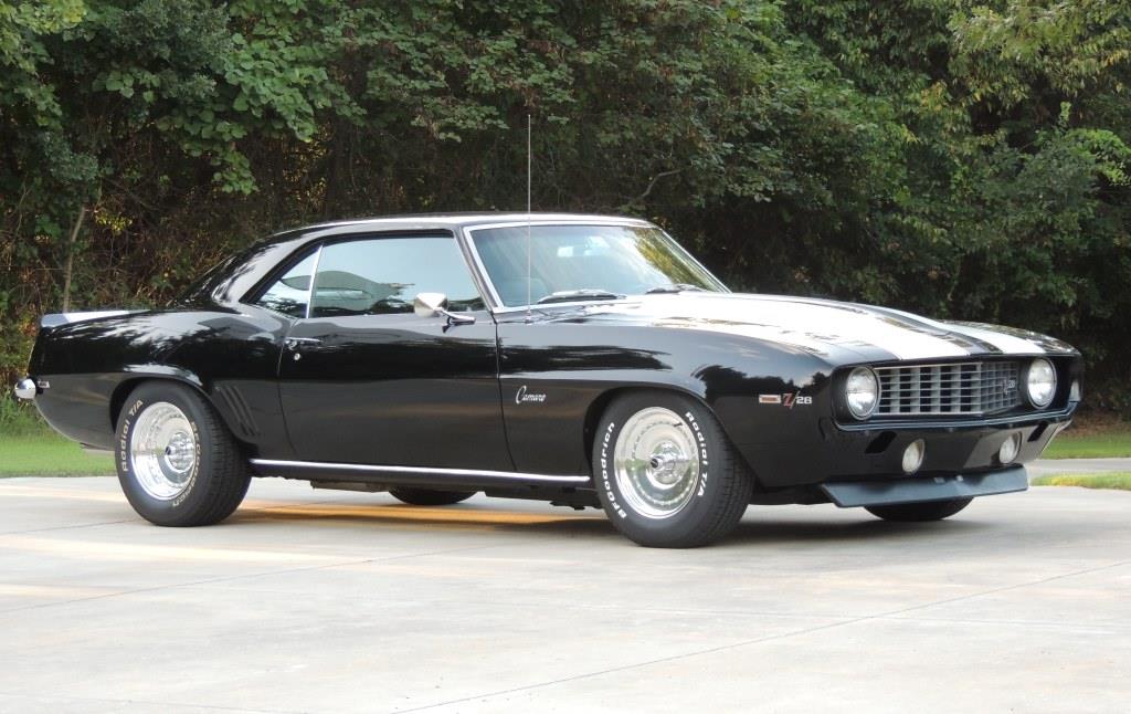

You can run them staggered. 215 in the front and 225 in the rear.
Just for perspective, I run 255 60 15 in the back on my Centerline wheels and they are not even close to rubbing. Have seen some guys running 275 60 15, but I had a pair on there, and am certain they would have rubbed under extreme conditions.
My 255 60 is actually a little shorter at 27.04 inches tall than the 225 70 15 (27.4 inches tall). And since they are 30mm narrower (about 1.2 inches) there is no way a 225 70 15 would rub in the rear. Lots more room under the rear.
I run 215 70 r15 up front on Centerlines (no style trim so no wheel well molding) but would not run anything bigger. I do not have the exact same off set as the stock rally wheels up front. I think plenty of guys run old F70 15 on rally wheels or 215 70 R15 radials on rally wheels up front. I kind of like the staggered look on my car. Of course, every time I put the rallys and the bias ply tires on, I really like that look as well.
Here it is both ways. I don't think I have any pics with the rallys after installing all the trim.
