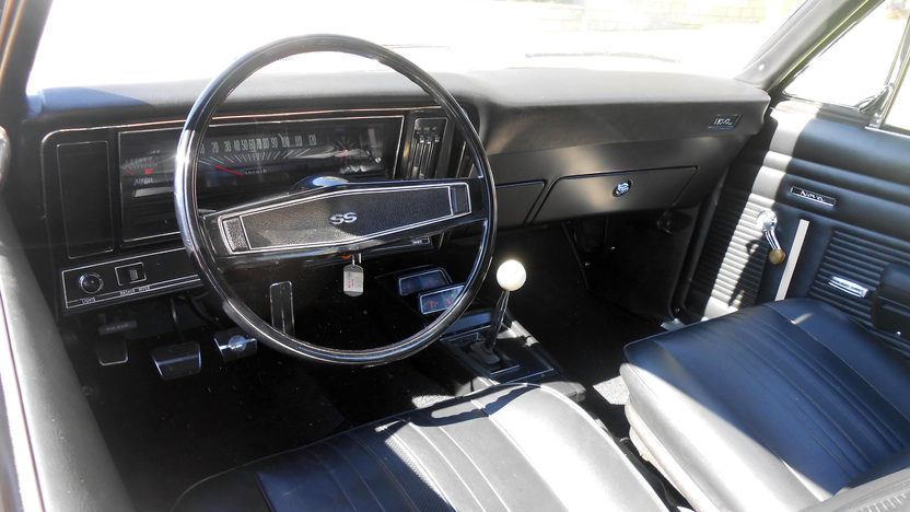

Need some help.. I have a 1970 nova. In the dash housing is a low fuel light. Car is a gauge package car, ie tachometer, clock. So as you know, on the floor, i have fuel,oil, temp and volt gauge .what is missing to make the low fuel light operational ?? Just the low fuel sender at floor console? Any help would be very appreciated!! Ie wire sch., pictures.

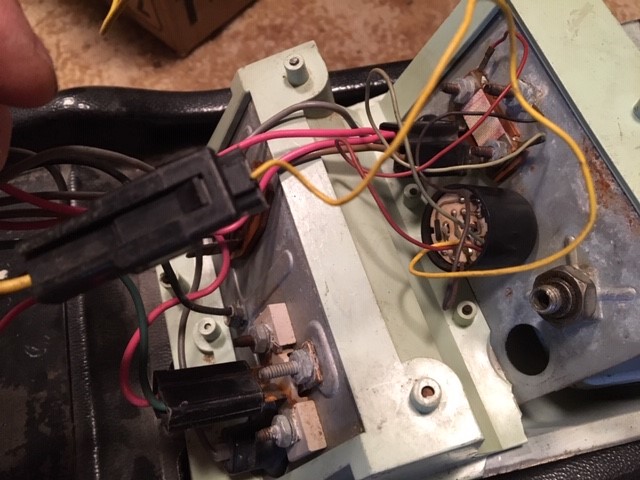

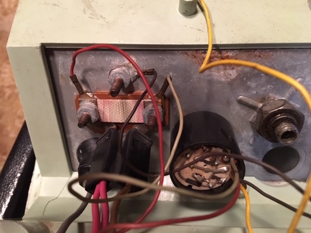

The low fuel circuitry is in a little pod on the back of the fuel gauge. There is a yellow trigger wire which feeds back to the cluster. Don't recall if it grounds to activate the light or powers to activate the light.
I have a loose gauge pod, I'll try to get a pic for you.

Nova Low Fuel sender

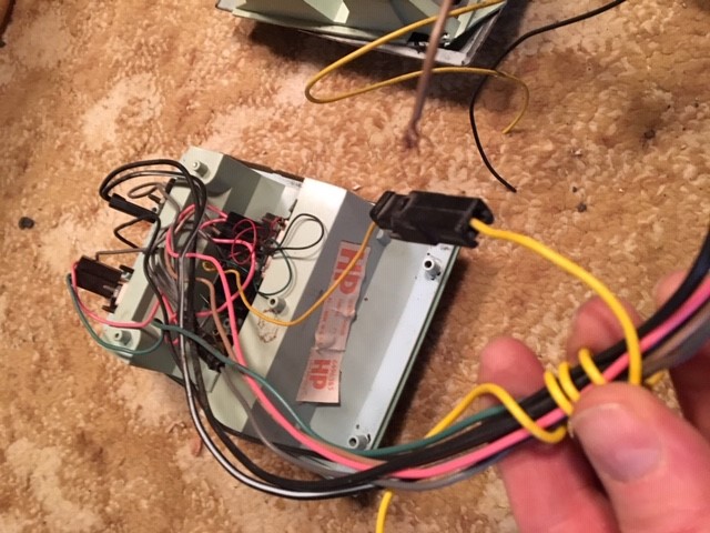

The yellow wire goes up to the dash and connects to the light. I'm not sure if it goes into the cluster harness or is just separate and hooks up at the light. I do not have the dash from either of these gauge clusters. The Yellow wire appears to be separate from the console harness.

I would think the Low fuel light goes into the pod where the oil light would be (without gauges). Thusly the yellow lead would likely replace the oil sender lead in the cluster plug and ground when low fuel to illuminate the bulb.
I'll see if I can find my wiring schematic to confirm.
Share some pics of your cluster where the Low Fuel indicater lens is.
