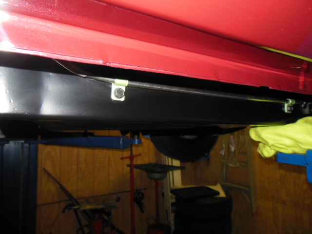

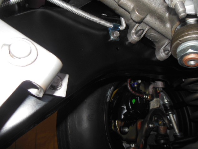

Need to know what color clips go where & color or plating type on a 69 camaro this is some of what is on the car now

3/8" are plated and tinted blue, 5/16" are green. And I believe the clamp with the open notch are bright plated and not colored
