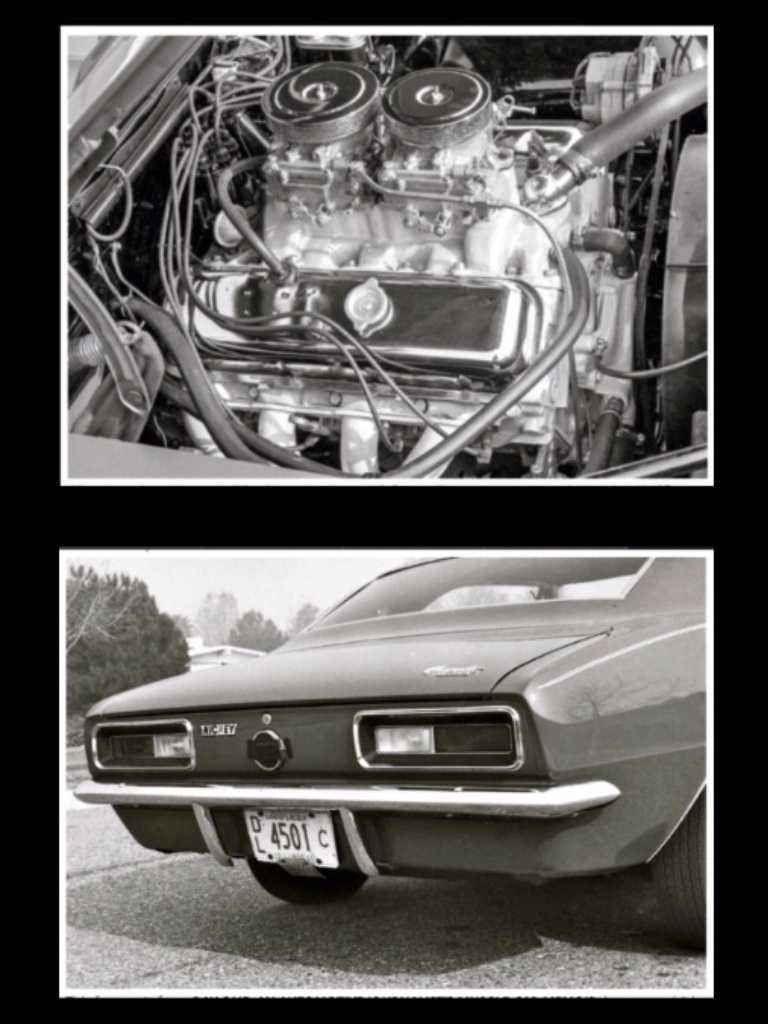

This discussion usually ends @ the same conclusion w/ others doing conversions early too but the Jan.'67 Tach Magazine Nickey car the first 427 Camaro ever made available to test.
Here's a few more related pics, first shot from the Tach Magazine Dual Quad article w/ Nickey on the Doors...which sure looks like the car in the next picture on the Nickey/Harrell Ramp Truck?
Note the Nickey Dealer Plate # in the rear shot w/ taped over SS Gascap is slightly different than the Plate # in Joe's pic above also the Dual Quad car in the next two Nickey/Bill Thomas booth pictures @ the first SEMA show 01/67 may be this same car again?
Last is an 11/66 LA Newspaper article mentioning Nickey 427 Camaros from Chicago coming to Lions Drag Strip...were these street or drag cars also did they show up/were any actually there in Nov. '66?
