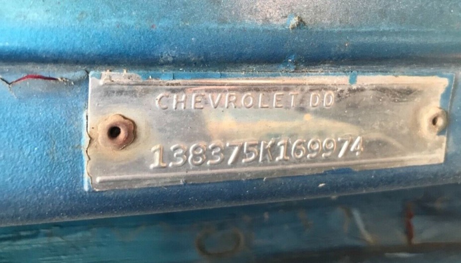

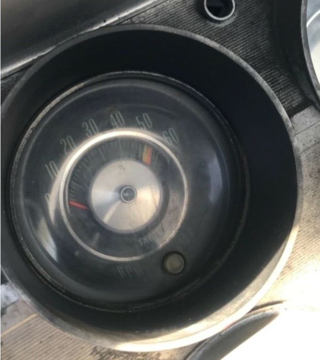

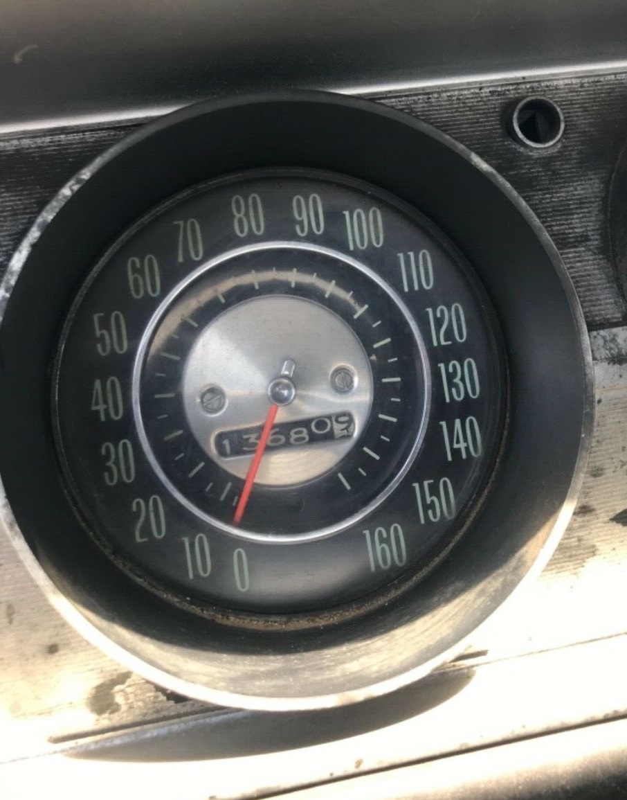

Default Interesting...Z16 project.
Not many details other than..."this is the Z16 Malcolm Durham bought new This may be the most famous z16 ever "
https://www.facebook.com/marketplace...2057915544918/

Attachments - The Supercar Registry Capture Z16 VIN tag.JPG Capture Z16 tag.JPG Capture Z16 tach.JPG Capture Z16 speedo.JPG

Jeff Helms confirmed the car to be the real deal. Here is the previous discussion on it when the car was posted on Craigslist.

----Why does the dash have an AC vent for starters?.....Bill S

Driveshaft (heavier than a 65 small block shaft) Gas tank sending unit Speedo cluster FM radio (available on other 65 Chevelles but very few were ordered, and it is a very expensive part) Multiplex - contrary to popular belief these are Z16 specific. Not the same as an Impala or a 66 Chevelle. A real original Z16 MPX will actually have a blank Delco Radio Model # sticker with a hand-written number on it! Multiplex mounting bracket Kick panel speaker grills Remote mirror (available on other 65 Chevelles but few were ordered, and it is a very expensive part. And contrary to popular belief certain components of the mirror do not interchange with a 66 remote mirror) Rear trim (obviously) Decklid (you could weld all the holes shut on a regular decklid but it would be a challenge to grind the back side down and metal finish all those holes up inside the inner liner structure without someone with an eye for detail being able to tell). And I am sure there are other trinkets I am forgetting. Then add the fact that they were all (except the prototype) built at the KC plant, which means that to do one "right" you need to get all hardware that has the correct head markings and finishes for late Feb - early April built KC Chevelles, and hood hinges and hood latch with the AVM manufacturer's stamp that was on all 65 KC Chevelles but not on east cost built cars, and various other KC-specific details. So the intricacies (and cost) are never ending!! Especially if you try to use only NOS parts wherever possible.
Was wondering about that myself? Thought maybe this car actually got AC????

Link to ebay auction... https://www.ebay.com/itm/1965-Chevro...97.m4902.l9144
"This car was bought new by Malcolm who was a very famous drag racer He removed the motor and transmission and used them up in his race car He replaced them with a big block and a turbo 400 added a/c and the Malibu trim and painted it blue like his race car and have it to his wife to drive It was sold and the second owner took the motor and transmission out and sold it on to the current owner in 1977 it has been in dry storage since 1977and has some typical rust but the floor and frame are good The trunk and some body panels have rust and will need worK He has bought many parts fo the car which go along with it included fenders doors and quarters all nos All of the parts are numbers correct but were not on the car new (transmission heads intake ect) Too many other parts come with it to list Item is for sale locally so auction may end early Feel free to contact me for more info."
VIN: 138375K169974
