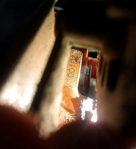

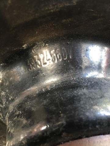

Looking to purchase this 1969 Z/28 … Would like some help with the Pad stampings and the Cowl tag please. Do they look correct and original? ANY help would be appreciated

The tag is perfect... NO PROBLEMS
I would not want to make the call on the engine stamp because the BROACH PAD NEEDS TO BE CLEANED WITH lacquer thinner before a LEGITIMATE determination can be made.

Old 07-27-2019, 01:19 AM
cook_dw's Avatar
cook_dw cook_dw is offline
Join Date: Oct 2003
Posts: 4,388
Thanks: 672
Ditto what James said

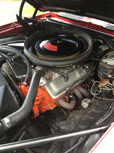

Am I seeing things or is there a crack in the cylinder head and looks close to the push rod. Not sure if it's just the picture, Or I'm just seeing things.
Old 07-27-2019, 11:49 AM
BARRY BARRY is offline
Join Date: May 2002
Location: ACTON ONT CANADA
Posts: 1,294
Thanks: 8
Thanked 71 Times in 39 Posts
Default crack
yes sure looks like a crack

Yes it does look like a crack ….. This car runs amazing too.

Looks like a hair to me.
Jason
Old 07-27-2019, 03:31 PM
firstgenaddict's Avatar
Posts: 5,596
Thanks: 161
Jason
X2...
