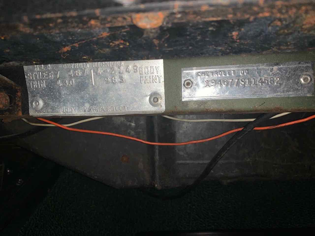

6000 RPM tach. 350hp if memory serves me correct. I don't believe AO Smith bodies got side exhaust either.

I noticed the discrepancy between the 300 horse engine and the 350 horse tach.
It is certainly not a sidepipe car with that trim tag.

----Sounds as if the car is a Cutlass in disguise. Cool car but I wonder what that does to the value?...….Bill S

Not buying the "perfect" California birdcage claim. Those tags have a lot of patina and the cross bar has a lot of rust. I've never found one that has rust on the cross bar and did not have quite a bit more rust in the cowl and door pillars.

does that trim tag look correct , never says if the drive train is original to the car
